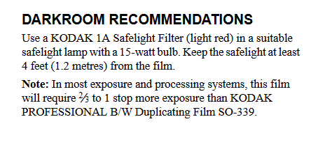

In my experience, the "SO" designation means "Special Order" and was used by Eastman Kodak when they began coating their standard emulsions onto Estar base.
Mentioned here:
http://www.taphilo.com/Photo/kodakfilmnumxref.shtml
Also mentioned here in the tech sheet for SO-132, so it was probably just a more sensitive formulation of this stock.
https://125px.com/docs/film/kodak/f11-Duplicating_SO-132.pdf
