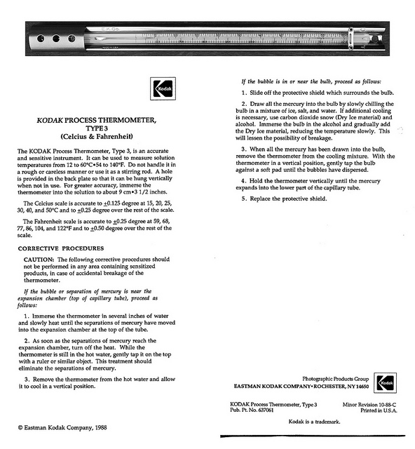

So I found a copy of the instructions on flickr, and realize that my thermometer probably is a mercury thermometer.
Here are those instructions, plus a much reduced image of the thermometer itself:

Note the degree of accuracy at the marked temps is +/- 0.25 degrees F. And those temps are actually marked on the column to stand out. I have both a type 2 and a type 3. The type 2 is an earlier version and only accurate to 0.50 degree F. More suitable for lower temps and black and white.
