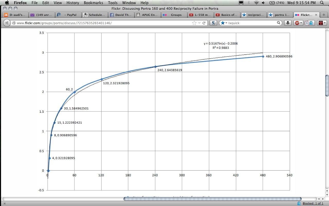

This is an *unverified* chart for Portra 400/160 I downloaded a couple of years back, but can't seem to find online anymore. Seems to be fairly accurate in my experience.
attachment.php
  • Portra 400:160 reciprocity failure (unverified).jpg
