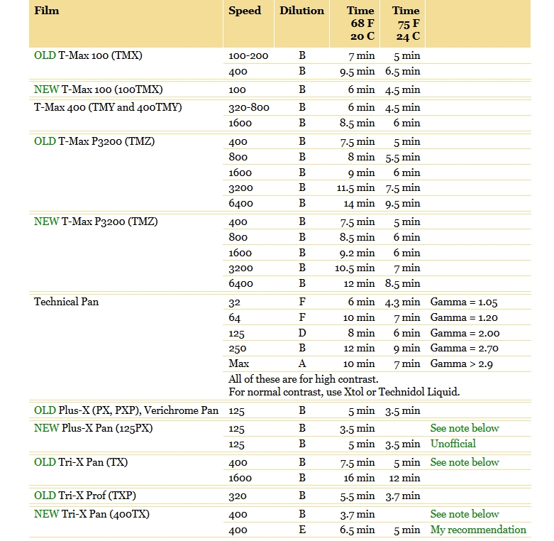

Ok, i found an answer on Covington page:
Covington has doubts that the 125 Plus-X kodak time dev is reliable.
But thanks for the tip.
I went with HC-110 (B) 10 min. :smile:
