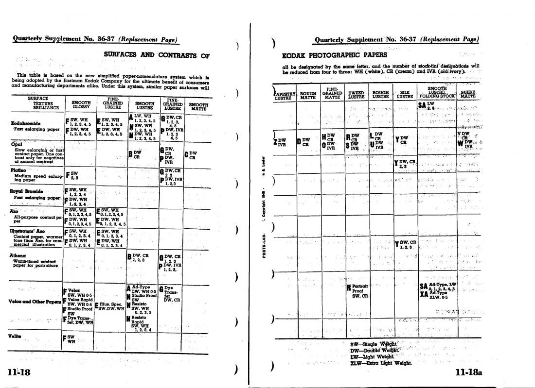

An interesting history. Kodak papers were once available in a huge variety of surfaces - many colors an textures. I have attached a table from an old Photo Lab Index (late 40s or early 50s) that shows what was available near the peak. There was pretty good demand for this variety at the time. Eventually, the selection diminished, probably due to lack of demand and to the discontinuation of Opal. But even in 1971 there was a large number to choose from. The second attachment is from the "Kodak Professional Papers" booklet of 1971. The number of surfaces available today from all manufacturers is only a fraction of what we have here. Also, we used to have paper colors - white, cream white, old ivory. There is nothing like that now. Ink jet papers give you some choice, but not the rich variety of the old photo papers. And ink jet prints are not like silver-gelatin.

Azo paper alone came coated on 19 kinds of paper support. They have samples at George Eastman House.
