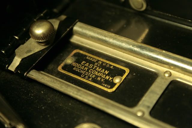

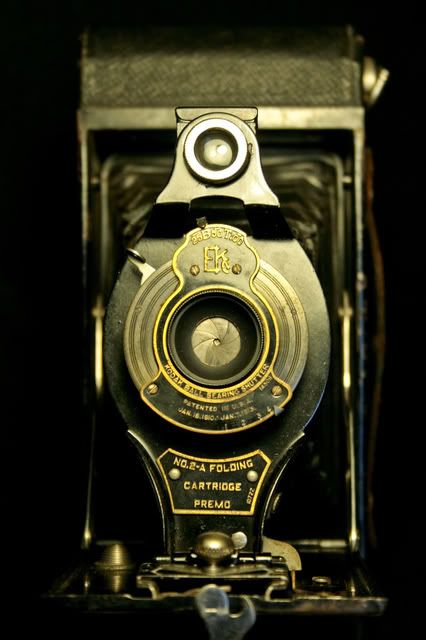

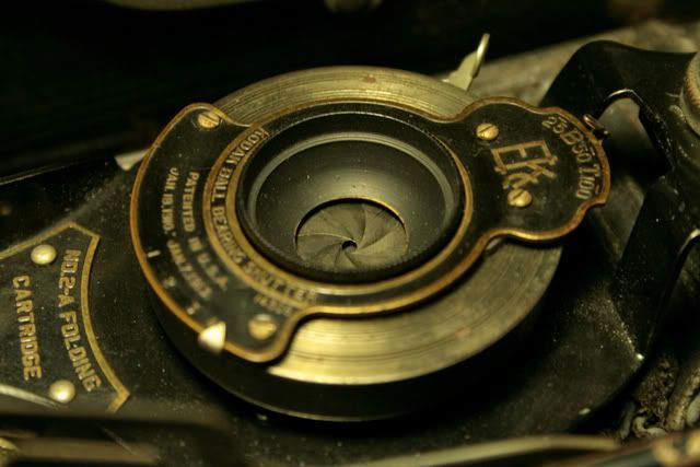

Hi All! I'm Danny, to day I just bought a Kodak No. 2 folding cartridge Premo for $7.00. It seems to all work just fine. I don't know much about this camera and was hoping you could tell me more. The aperture gos 1,2,3,4. I think thats f11-f32 right? I think it all so says to use 116 film, but I know they don't make that anymore...so can I use 120? I thought 116 was about 1/4 inch wider.
Here are some photos I just took.
