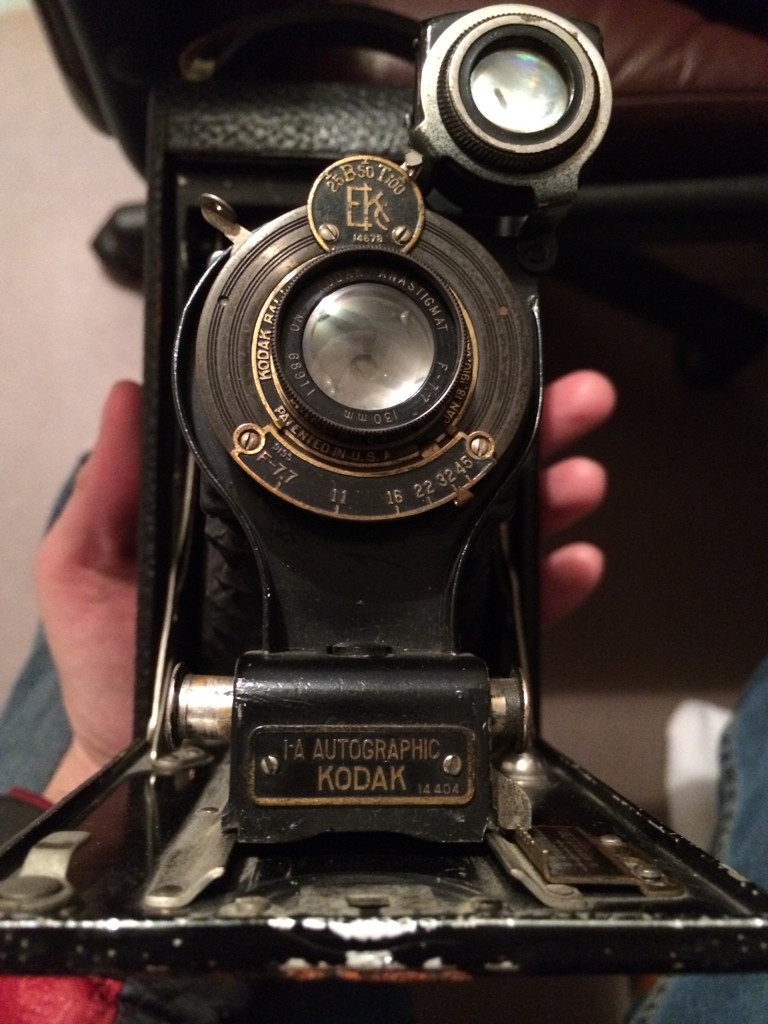

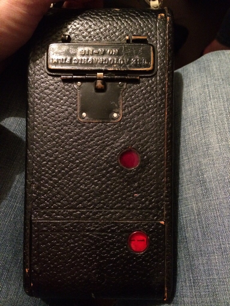

So I have had this very old Kodak 1-A autographic folder Kodak for a long time now, but I haven't used it and have instead use my newer "point and shoot" 116 Kodak with the crappy "Twindar" lens.

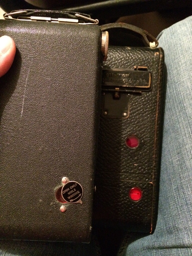

Anyway I have wanted to use the nicer one for a long time, but I can't seem to figure out which of the two red view windows I'm supposed to use to lineup the number?
The newer model seems to indicate that should be the bottom window, however I don't understand why there are two windows at all, what does the second window serve for, and which one am I supposed to truly use?
I know that this is the autographic version, but my 120 Autographic doesn't have any second window...
Any old beards want to help?
Thanks!

The cameras with two windows tended to have a feature which allowed you to shoot more than one format, by inserting different masks.
Each format required its own red window.
I've never seen that on the back of a 1A Autographic - it certainly isn't there on my 1A Autographic Jr.
I would use the window nearer the end, because that is where the window is on my 1A Autographic Jr.
Oh I hadn't thought of masking! Duh! Haha but I can't find a manual for this camera version, not even on Butkus...
I figured the bottom window was right since the other 116 had the window there.
But then I thought maybe this was a fancier "autographic" and you could write more than the window so maybe it gave you more room or something...
Really wish Autographic paper still existed... Wonder if it can be hand made...

Use the first window that the No. 1 gets to -- the masking thingy worked by cutting the film frame in half and using each number twice.

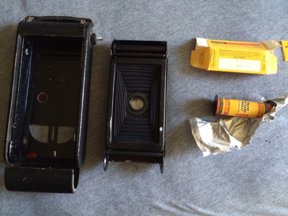

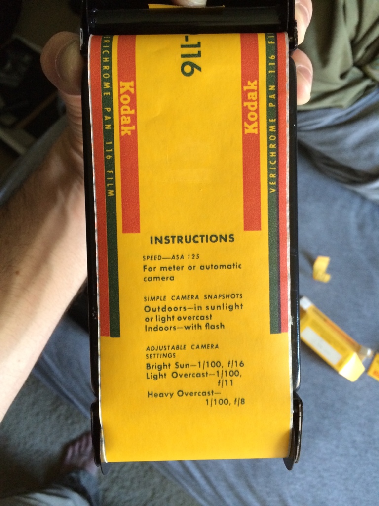

Thanks! This is cool!
I can't seem to figure out where mine is in the production line, the 120 I own seems older than my 116 but the 116 is fancier for sure, with a better lens, and faster shutter.
I just shot 8 exposures in my yard on Verichrome that expired in 1946-1948 (I forget exactly). And on the side the patent stamps stopped at 1917 as the newest patent numbers, there were a ton from the US and only a couple for Canada and a few for Australia... Strange.
Anyway, it had hidden buttons, the leather is supple, and though I was forced to put gaffers tape over the two red holes, knowing of course that some of the leather around the hole would pull up and be ruined each time I lifted the tape to advance to the next frame, I know that this camera would be happier to be used and get a few scrapes than to sit on a shelf...
Can't wait to re-load it with the fresh 116 film and have a blast!

One of my 1A's came from the original owner along with the instruction book and a folding metal tripod he purchased at the same time. There is only one window and no mention in the instruction book of the possibility of a format mask. The additional window on yours being offset for the line of the normal window makes me wonder if someone added it maybe to use some other size of film. Would that window line up with one of the outer rows of numbers on 120 film?
MattKing
Apr 24, 2005
54,740
Delta, BC Canada
I was wondering the same - the second window does look like a bit of an "add-on".
That is an interesting thought, it doesn't appear as if there is some kind of insert to take another size film...
It also does not have the mask.
The thing I find most interesting, is that the window that supposedly is the one that I should not use is much much darker in red color than the lower window, so the two windows are actually of different densities of red...
As per the roll film numbers themselves, the camera numbers typically don't to seem to have any kind of relevance from one number to the other, and they were probably a few one a type cameras that were all different with no real explanation except that Kodak probably wanted you to buy a new version of the same camera to make double the money and call it something different lol.
So your version of the one eight may not be the same as mine it's certainly not the junior version, the one I have is the regular, I also noticed that nine on the back only says "No. A", and on the front says "1-A" which is interesting because I don't see the "–" on a lot of other ones...
around the film gate there are there fins that flip up and lock ?
( a lot of box cameras do this cheaper than a mask and can't get lost like a mask ) ..
a bad guess but maybe you have an accessory back ( or a back to a different 116 camera )
and the person lost the mask or lost the original back and used this one because it fit / was close enough.
the 3A ( the camera whose manual i copied the attachment from ) had accessory backs
split frame backs and a ground glass and plate back .. so maybe .. its not the actual, original back.
