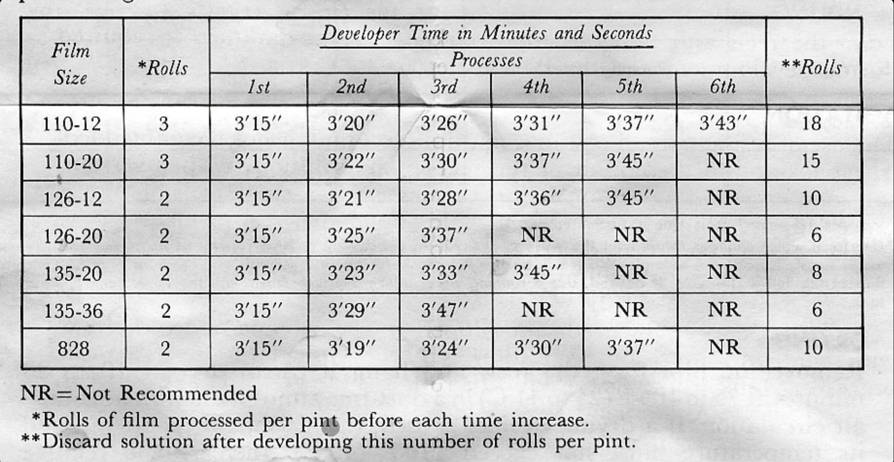

I found it.
PE posted that long time ago. RIP

This is for a pint.
So for a liter I assume I can double that

This is for a pint.
You should be safe in doubling both the number of rolls before incrementing the time and the total number before discarding the tank solution.

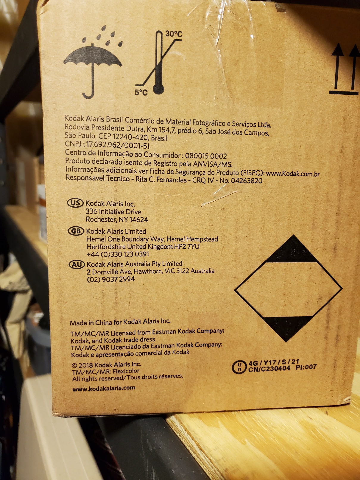

Can both of you indicate whether the badging says Kodak Alaris, or says Sino Promise?

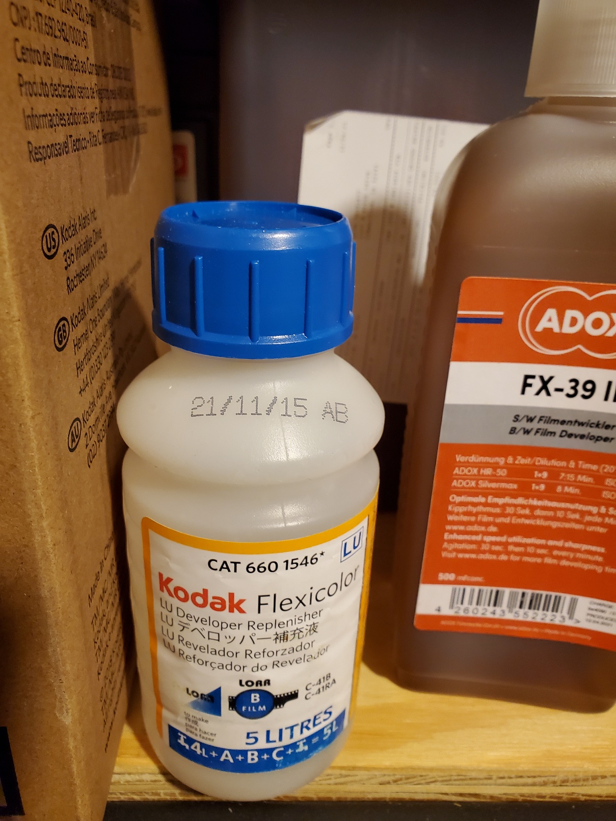

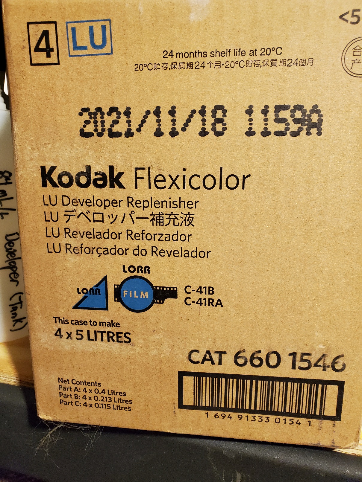

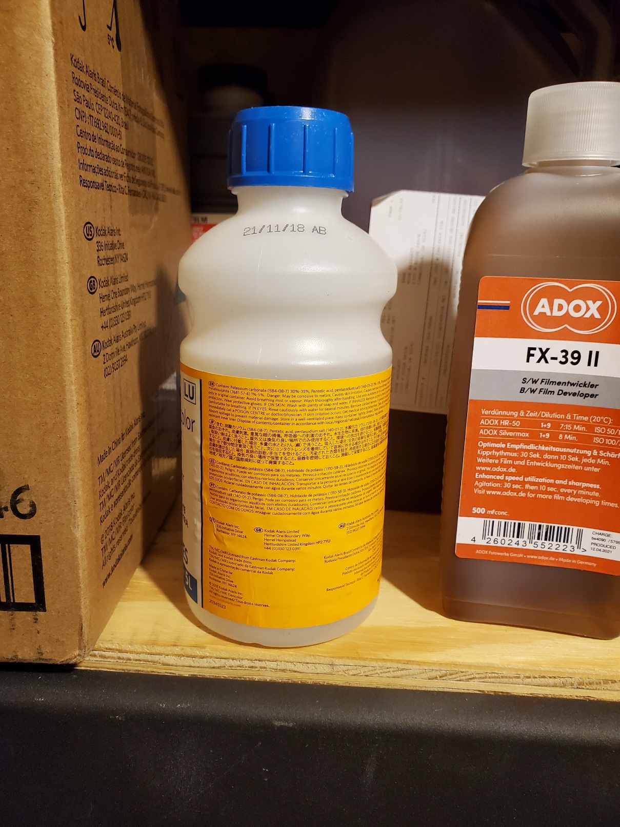

Everything is still in Alaris labels. Not what this means? Old stock, using up labels? I wonder if there's someone in China on this forum who knows what is going on with Sino Promise???

I think those are best before dates, not manufacturing dates - No AB on the code. The sale of that business segment to Sino Promise completed November 1, 2020.
The bottles have AB I'm pretty sure this is old stuff. Made prior to Covid and the apparent collapse of Sino Promise. I wonder if Wuxi China plant is still going? I will use this, no worries.
