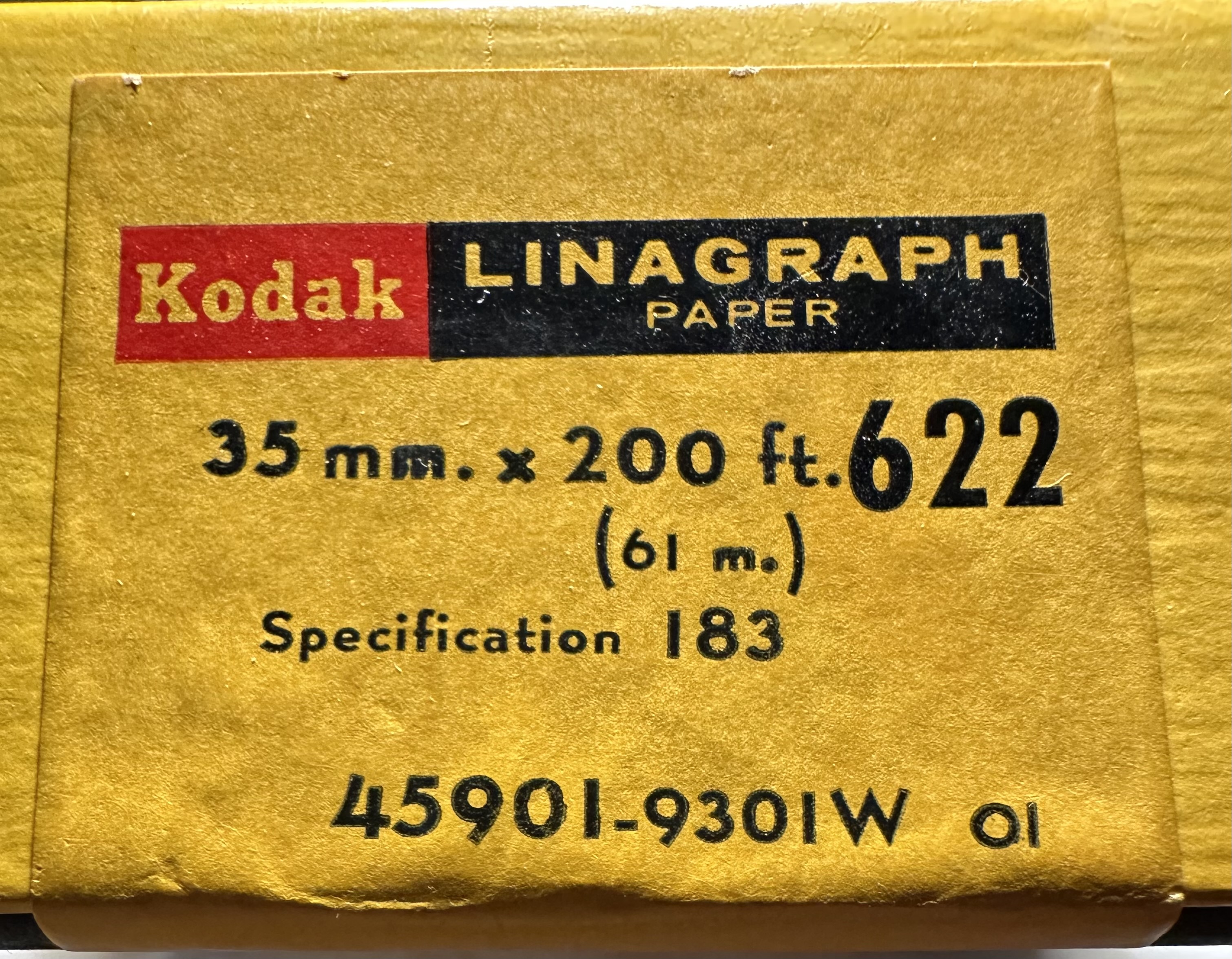

Hi dears, i recently purchased a vintage roll of kodak linagraph 622 paper. It is a roll of 200ft and it is 35mm wide. The box is still sealed and before i start experimenting with it i’d like to know what it was originally made for? I can’t find anything on the net about it. The width suggest paper negatives but if so i wonder how it was used, what kind of camera etc…
Any thoughts?

Probably for printing Linagraph/Shellburst films onto? I have some EK Lina/Shell film, but mine is 70mm. I think the film was used in high-speed cameras for photographing weapons tests, which were then contact printed to paper, and analyzed frame by frame to see the development of explosions over time. Mostly just spitballing here, but I do have the 70mm film...

Shellburst film was for distinguishing explosion plumes from the bright blue sky. The emulsion is thin, it develops low-contrast. I had Linagraph paper before - it developed low contrast in Dektol and I never tried it in lith developer (which is probably what was intended).
