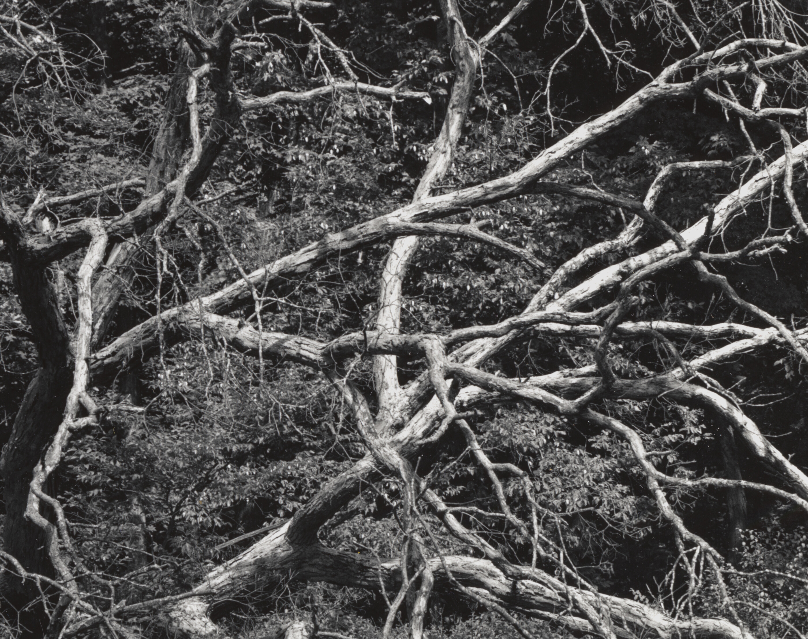

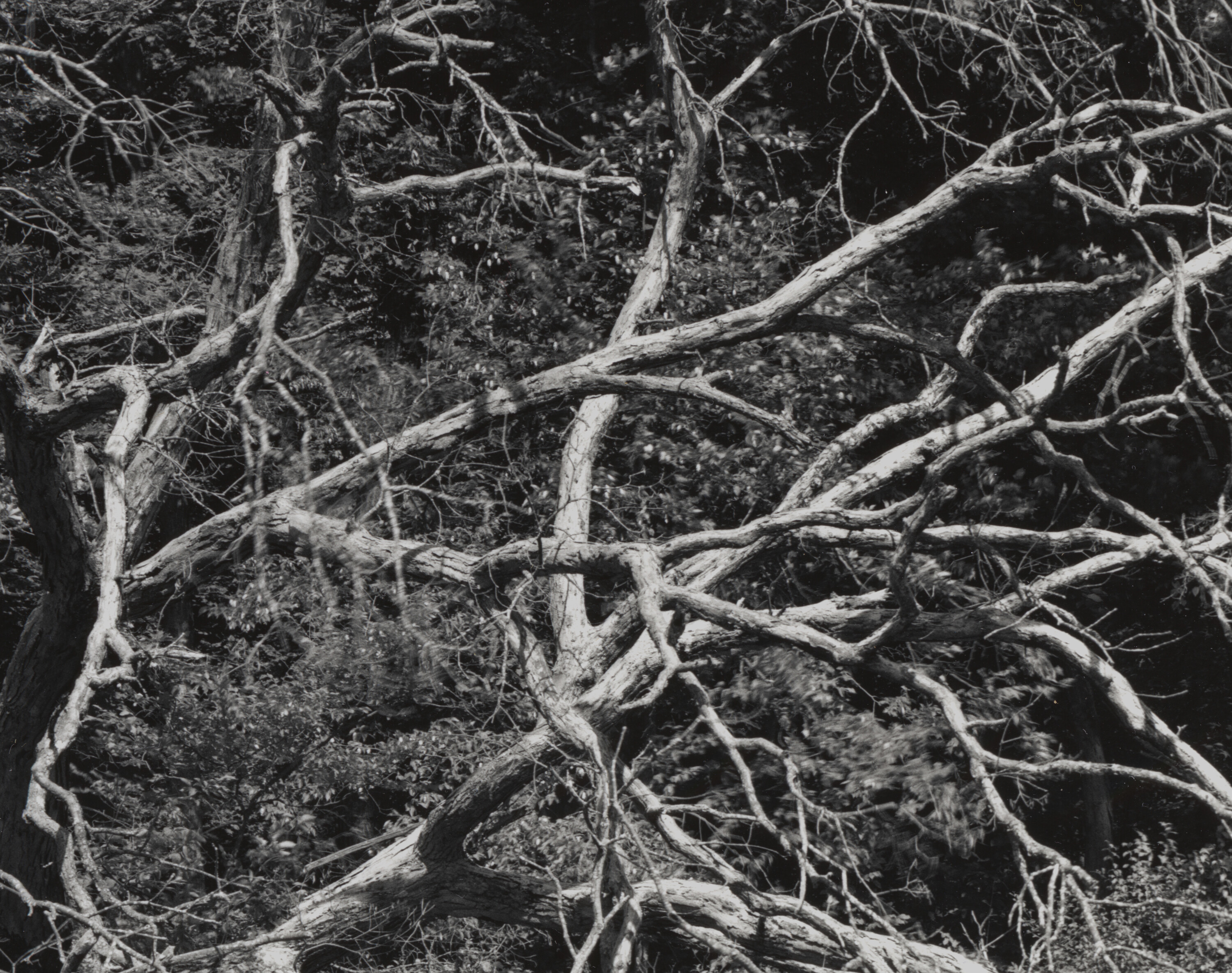

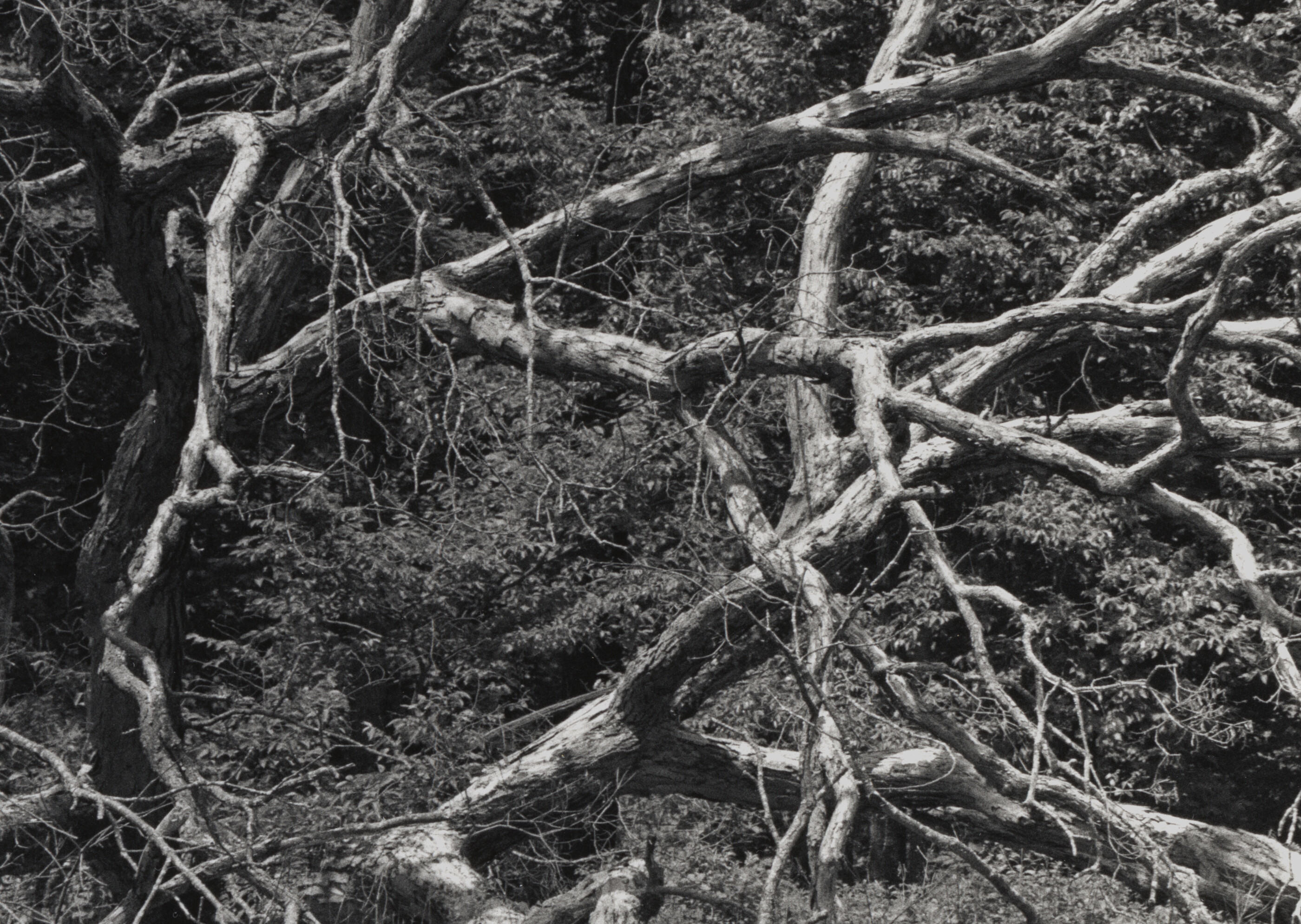

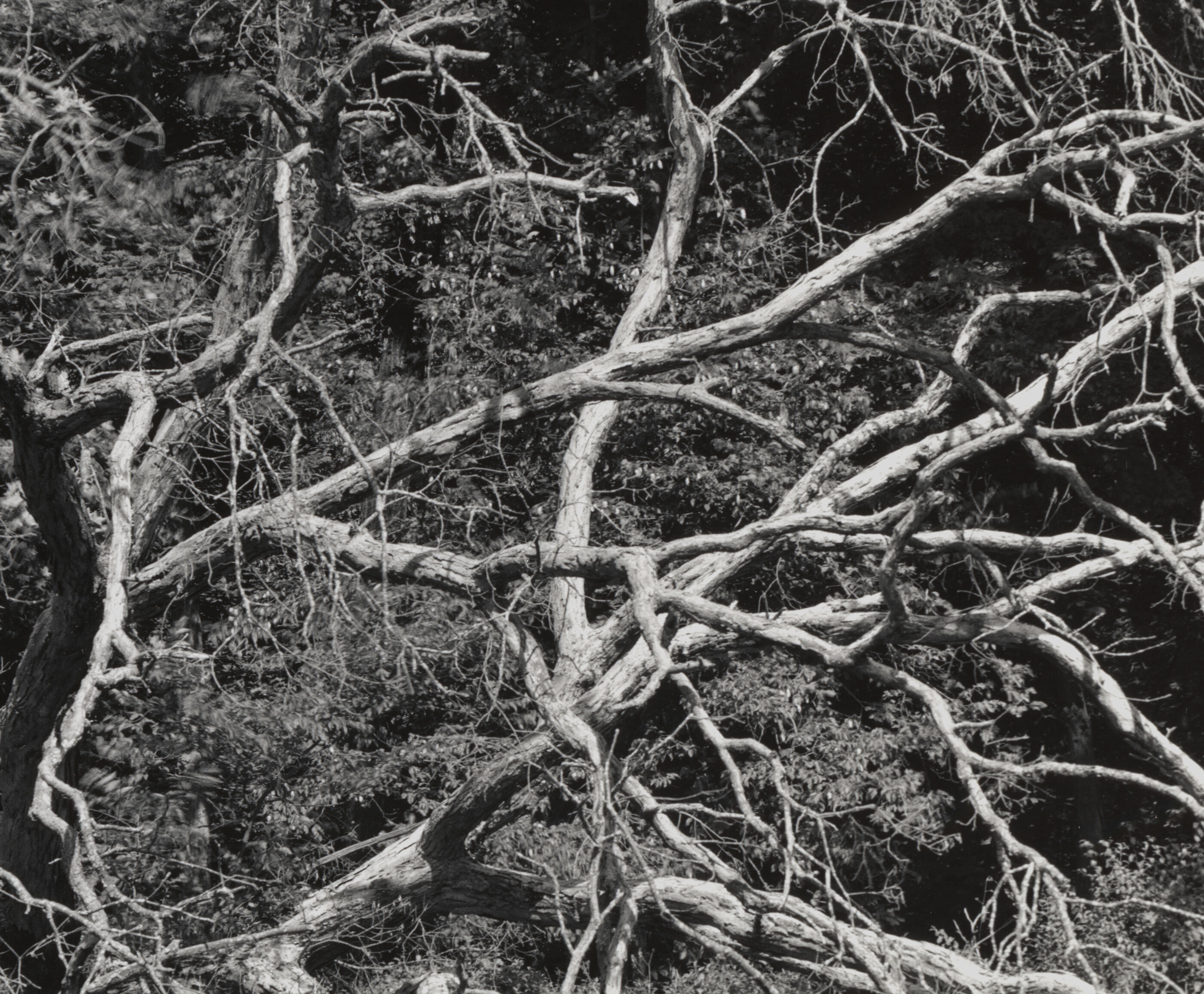

OK, some scans.
But first a few notes and caveats:
  • Scans are of a small central section of 8x10 workbook prints on an Epson V800.
  • The only post scan processing was to adjust contrast and white/black point as best I could to match the actual look of each print. There was no sharpening or other fiddling.
  • There is no guarantee that you will see what I see because monitors may not match and monitors never properly match reflective print media.
  • Tri-X and HP5+ were rated at EI 250, PL100M at EI 160.
  • Development for both developers used was 3 min prewash, 2 min continuous agitation, 15 sec agitation at around 13 mins, and total development time of 25 min. Processing was in a Kodak 1/2 gal rubber tank with the film suspended vertically from a single pinch clip (Kodak Hanger #6).
  • I did these tests to check my film and way of working. I have hundreds of sheets of 2x3 stashed in a freezer and I want to make sure I get everything I want out them, since they are a non-renewable resource. If this doesn't interest you, do feel free to ignore - it won't hurt my feelings :wink:
tl;dr
The actual prints show differences:
  • PL100M sharpest followed by Tri-X then HP5+
  • The difference in sharpness between Tri-X and HP5+ was more pronounced with D-76 1+3. D-23 1+9+lye showed both to be very sharp.
  • Tri-X showed most natural contrast, followed by PL100M, then HP5+
  • The Tri-X and PL100M contrast differences were more subtle.
  • The HP5+ contrast differences were more obvious
  • With very close inspection, the PL100M had the least grain, and the Tri-X and HP5+ were comparable but in no case was it objectionable or visible in the 8x10 work prints.
Tri-X D-23 1+9 0.5g/l NaOH
HP5+ D-23 1+9 0.5g/l NaOH
Tri-X D-76 1+3
HP5
+ D-76 1+3
PL100M D-76 1+3
