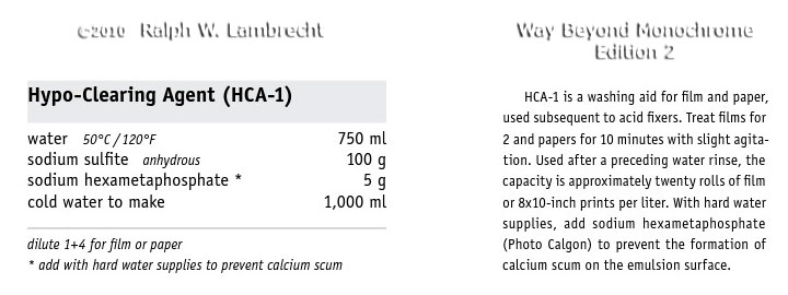

I agree with others that HCA is probably one of the easiest photographic chemicals to mix yourself. I can offer the attached formula, which I use for years.

Just saw Ralphs post about the photo calgon for hard water , I bet that is what is giving me the grief.
