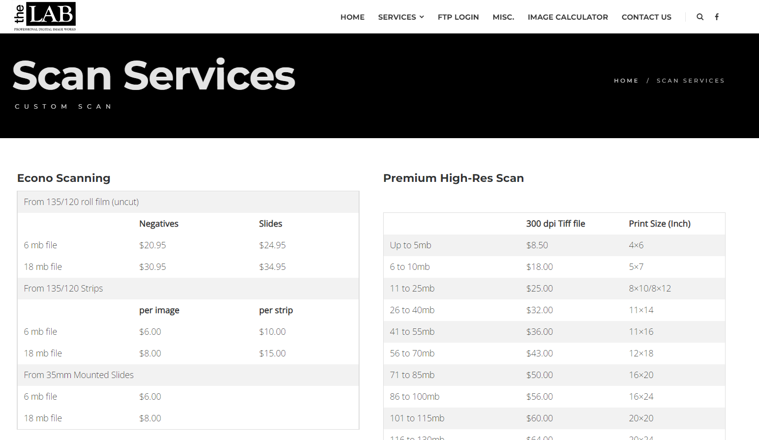

As an example, one of the two labs around here that still do pro quality work and optical prints:

fair enough, and if everything being equal, the file size could be a rough estimate of picture quality, though, the reality is, everything isn't equal, as evidenced by the right hand side under the premium high-res scan. How can a premium high-res scan be higher quality at 5MB than the 6MB Econo scanning on the left? It's exactly this kind of tom-foolery with file sizes that causes so much confusion with end users. If an end user cared enough about resolution to be asking about it, they should be putting enough effort in to learn about Megapixels and pixel bit depth, not Megabytes, because Megabytes is not an accurate predictor for image quality and never will be.
