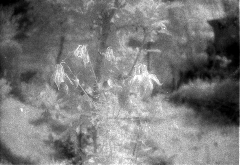

So here's one of the first ones. Yikes, it's grainy!
