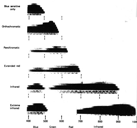

A semi related question to PE or someone else. Why does HIE have such a big dip in sensitivity around 520 nm?

I should clarify about the dip in sensitivity. Is it there because that's just the way it worked out due to the sensitizer choices, or for other reasons? 520nm is really close to the peak sensitivity in human vision *and* the maximum reflectivity of chlorophyll...
Here are the spectral sensitivities of most types of films. What the OP is referring to is seen in the bottom two examples in the attached figure.
IR film can be made to be pancrhomatic and IR sensitive but it is more feasible to make them just blue and IR sensitive as the IR sensitivity is what is being used (or what the customer wants).
Therefore, most IR films have only Blue and IR sensitivity. The exception is EIR which is essentially pancrhomatic and IR sensitive.
It is my understanding that IR dyes become increasingly expensive as they are pushed to longer wavelengths and they become increasingly unstable to heat.

Swapping out the green sensitizer for the IR one(s) would make good sense, since most people who shoot IR are looking to get Wood effect. If the film were sensitive to green reflections and IR reflections then it might be too easy to "blow" the highlights off leaves.
Not sure why they'd want to keep the blue sensitizer though, it seems to me that you give up some sharpness as a result, because the film would then be sensitive to a rather broad spectrum over which most lenses are not apochromatic. Maybe they have no choice, maybe the sensitizers pick up blue as well. A lot of ring compounds absorb in the blue/UV.

The fundamental sensitivity of a Br/I emulsion is in the UV/Blue region of the spectrum. Unless one uses heavy UV filtration and a lot of Yellow filtration you are going to see the native sensitiityof the emulsion itself. If you Blue sensitize it, you see a rather pronounced bump in the blue sensitivity, usually at about 420 - 440 nm.
PE
Keith;
With a blue sensitive only emulsion, in the first row of the figure, it is difficult to say, but in the remaining examples, you see how the sensitizing dye represses blue sensitivity? In those cases, a blue sensitizing dye would have left its trace as a distinct peak in the range I gave. It would show up more clearly. So, in full answer, to #1, IDK, to the rest, most likely no blue sensitizer, just native remaining blue sensitivity.
I'll qualify that by adding that the last row example may have a blue sensitizer. Note the increase in peak?

One thing is curious in that last one...
the sensitivity seems to suddenly cut off somewhat unnaturally (on both ends but esp.) at about 675 or so.
Do you think this is an artifact of some sort ?

At least 2 if not 3 monochromators would have to be used for those IR exposures. There would be one more if UV was required. In the manipulation, I'm sure artifacts would apppear. My spectrosensitometer can do that type of exposure, but it must be in 3 stages with a reset and recalibration of the device after each separate exposure.

This is the nature of many such spectral devices. In fact, in the far IR case, glass cannot be used in some cases. We used cast Sodium Bromide crystals. They were about 1/2" square, about 1/4" thick and cost more than some people make in a year. They had to be stored in a vacuum dessicator while not in use.

Yup that looks like there was a lamp change. To take these data, one would ideally have a lamp with relatively flat output across the wavelength range, but that was basically impossible to get across the whole range from UV to IR. Now you can do it with a really good white light source e.g. a Ti:Sapphire laser pumping a photonic fiber, which they most assuredly did not have when this data was taken. Back then I guess they would have switched lamps, corrected the relative intensities for the lamp spectra as best they could, and just stitched the different wavelength regions together... probably with a copier machine and some tape :wink:
Just so Keith. The monocrhomator and the power supply have settings on them to do just as you describe.
