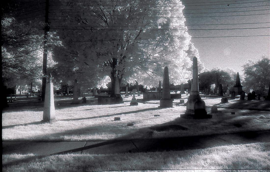

HIE test
I scaned a few frames and here is one of the better shots.Filter was mounted on the film rails and I set the speed to 50 ISO.Developed in D76 full strength for 9 1/2 mins.

Looks like a Sugar Maple in that cemetary. If so, they're the best for infrared. Good photo, too! I'd say your EI of 50 was spot on. I use EI50 for Ilford SFX.

Great image, Mike.
I am curious as to how you mounted the gel filter - could you please post a picture, or direct me to a relevant web page? Thank you!
