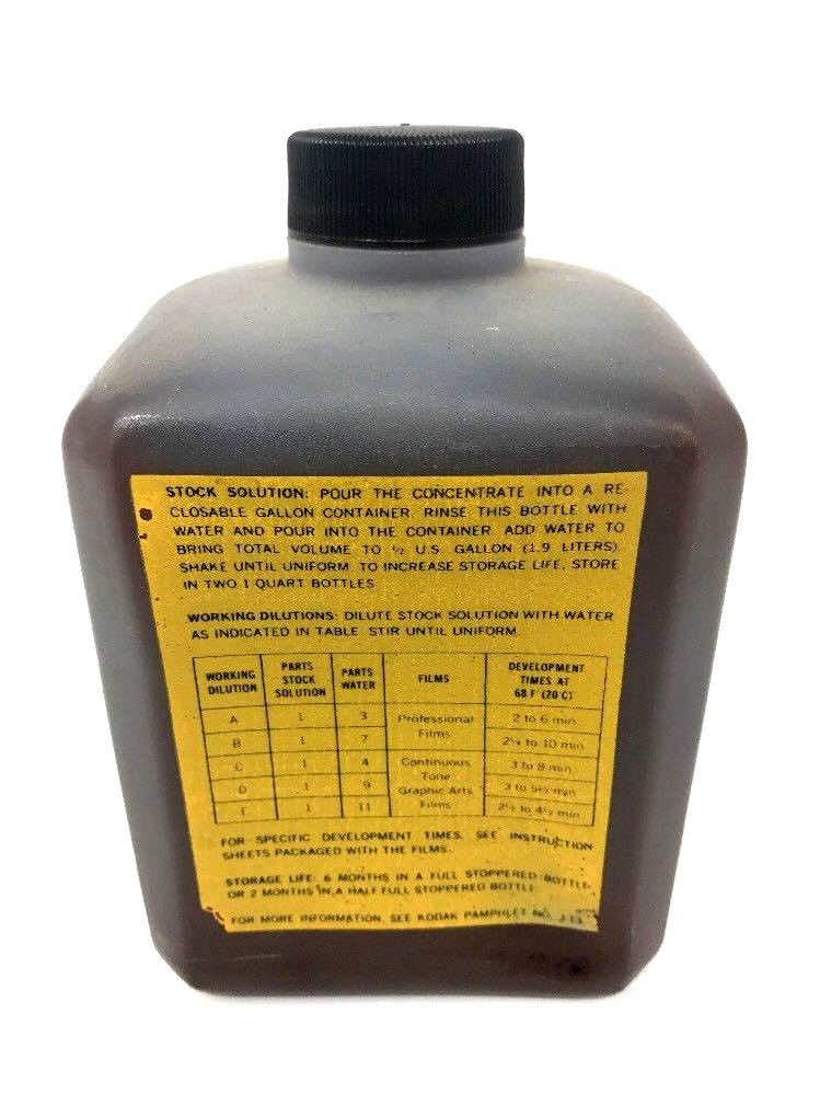

In the good old, the concentrate was sold in 1 pint bottles. You would dilute this to make 1/2 gallon of stock. 1 pint of concentrate would make 4 gallons of dilution B which would be plenty to fill a 3 1/2 gallon deep tank. Kodak sold 1 pint bottles of replenisher to go along.
Short answer no 1 liter is smallest. If you would buy some small Nalgene lab bottles you could split. I made 1 gallon Dilution B and replenished. I'm a 20 year XTOL convert, HC-110 was meant to be used from a stock solution. But once diluted it has a short shelf life. If I was still using I would decant into small 125 and 250 mL Nalgene lab bottles.
The old days, 473mL or 1 US pint of HC-110.
