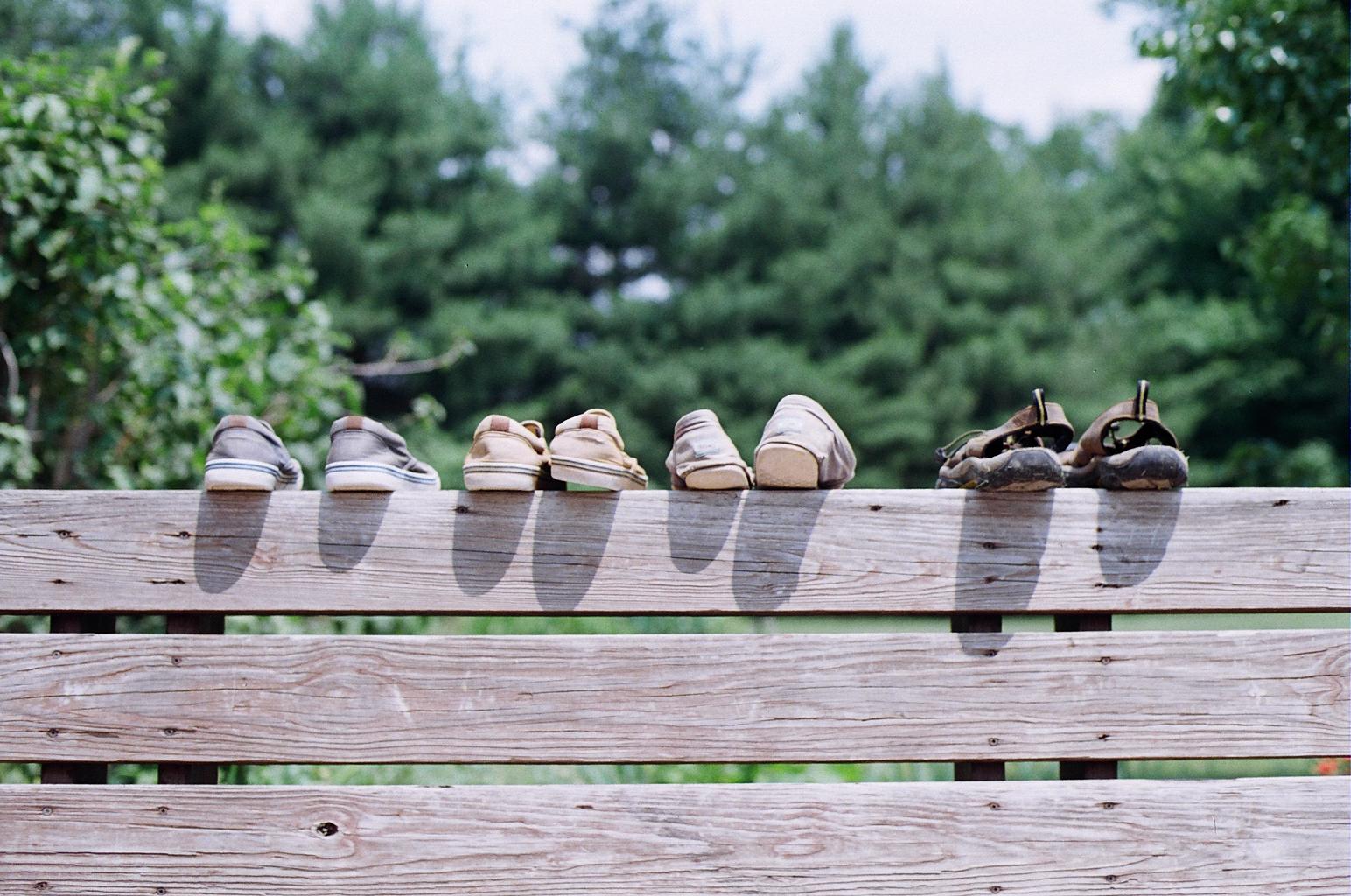

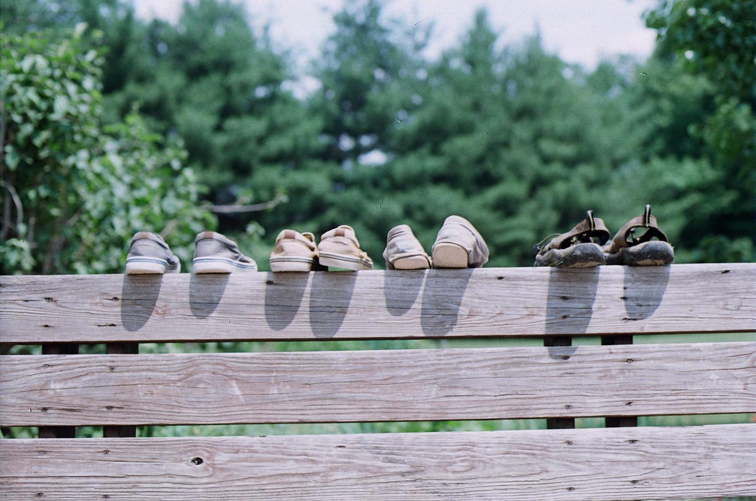

We had a nice stretch of high pressure and sunny days here in Pittsburgh earlier this week. During one such lunch hour, I shot a roll of Fuji Superia 200 and then a roll of Kodak Gold 100. Same camera -- a simple point-and-shoot with fixed aperture and shutter speed. The resultant shots show the Fuji to be nicely exposed, but the Kodak slightly overexposed. This is, of course, exactly the opposite of what I expected. Both rolls of film were developed at the same lab with no special instructions. Both films were purchased new, kept frozen, and had expiration dates in 2013.
I'm just curious if this is not an unexpected or unheard of result from one or the other of these films, or if I should look elsewhere for the problem. Maybe it's unrealistic to compare film speed between brands. Just looking for thoughts or ideas. Thanks.

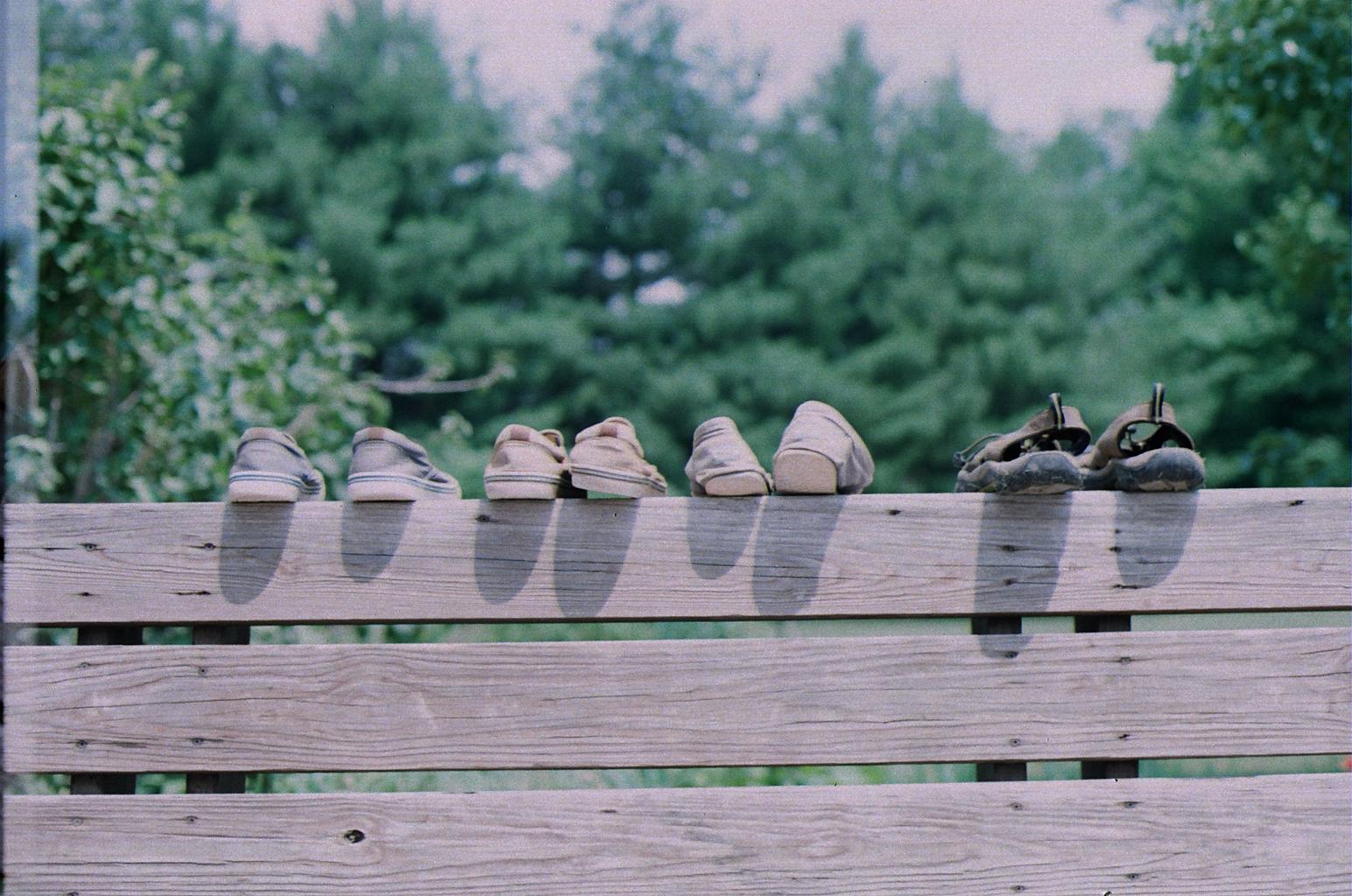

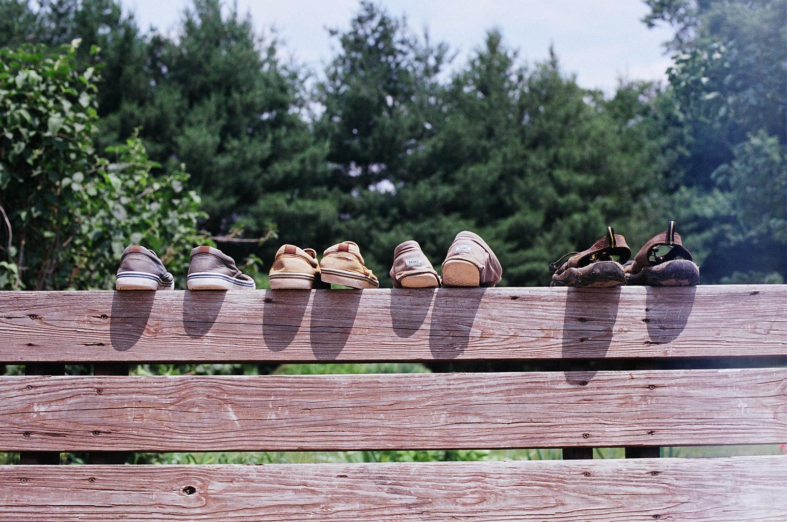

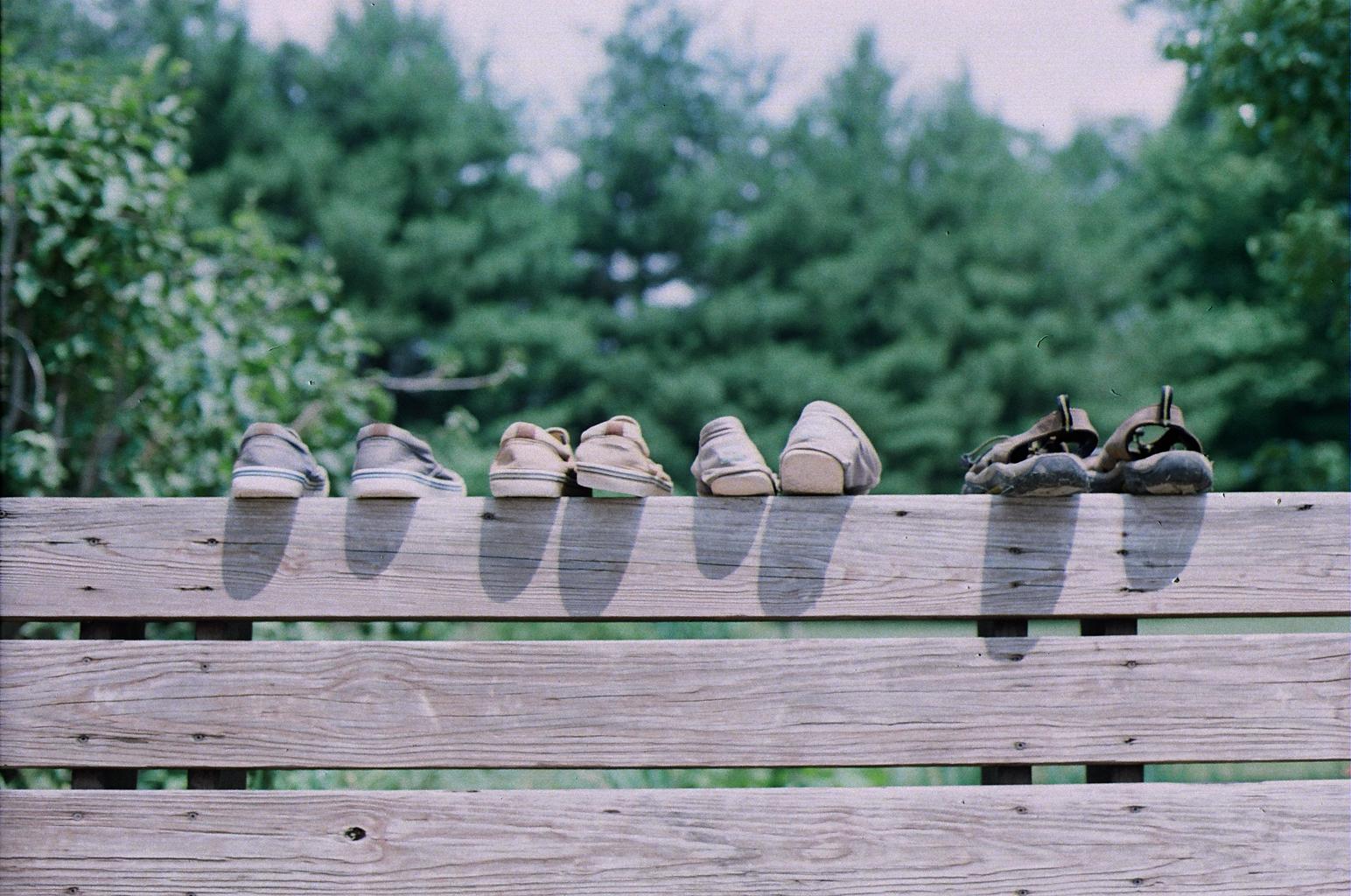

I won't be posting any scans. Simply requesting that I go through the exercise was enough. Apparently the Noritsu scans I get back from Target have exposure adjustment applied. To confirm, I placed the two similarly exposed negatives side by side on my own scanner, corrected for exposure on one of the Fujifilm (200) frames, and then applied that to the whole viewing area. (I hope that made sense.) The Kodak frames were noticeably darker than the Fujifilm frames. Vice versa when I started with one of the Kodak (100) frames; the Fujifilm frames were brighter.
So I stand corrected. I'm sorry for the trouble, but I'm still glad I posted. I learned something.
Now my challenge is trying to determine which speed film is best suited for sunny (i.e. EV15) conditions. The camera, by the way, is the Vivitar Ultra Wide & Slim -- great fun for casual, lo-fi shooting. It has a fixed aperture and shutter speed, but I don't trust the published specs. Not to mention, I'm sure every one is a little bit different due to the cheap nature of the camera. It probably doesn't matter much. But at least I know the film is working now!
