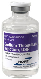

Fixer comes in handy as an antidote for cyanide poisoning, used intravenously. It's rather harmless, wash up with good warm dish soap, pots, pans, and hands. Next time dump it in a toilet or even better find a minilab that will take it.

Wow this is great info...!!!
