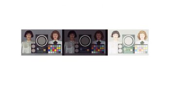

This is a film sample supplied from Kodak. One frame is exposed at normal one frame is a stop under and one frame is a stop over. I have scanned the film strip in its entirety. It is a strip of the their Kodak 400 MAX film. You use this to figure out the proper filtration for your enlarger so that when printing, assuming the photographer has lit the subject appropriately and the film is developed normally you will have the correct filtration. I just put it here so people could see it if they haven't seen it before. Maybe someone here knows more about these than me but thats my layman's explanation as to what this is.

These are used to set up printer slope (or curve). I believe most are two stops under and two stops over. After adjusting the printer to produce a good match with the "normal" , you print & adjust the under and overs until you produce matches. After that, in theory, the printer (with a good experienced operator) would put out good work.
In the "old days" we spend a good deal of time and paper testing "channels" on the printer to put out good, consisant work.
Now days, the set up is easier (I think :smile: ), but we spend a lot of time chasing down problems with computers, software issues, network problems and so on.

Hey Msage, I wasn't aware it was 2 stops. but now you mention it yes it is two stops. Thanks for this information. I had an idea what it was but i wasn't able to get any information on them down here. Are these made for all film types by kodak?

Shirley was the name of the live model that was in the original test up negative. She was chosen because she had "normal" Caucasian skin. She would be photographed thousand of times in a set up with gray scale and color patches targets. When she retired, and was replaced by another model and the name stuck. One Kodak rep (back in the old days when Kodak had reps who visited labs) saw the setup and met the current "Shirley". She said it was a good gig, but she had to avoid getting a suntan and other conditions that would alter her appearance. Currently a company named Aperion (?) makes set up negatives & digital set up patches. We purchased a Noritsu mini-lab in 1980 and made our own "shirleys" for a time. Later, Noritsu produced their own with a model they called Nora (Nora Noritsu :D), how funny is that! Sooner or later they all went to mannequins or dummies. No more complaints from the models, no bathroom breaks or lunch breaks.
The plotting sheets had a publication number like y-55, I think Kodak still makes them? We plot on the computer and have for a number of years. 5 or 6 years ago we were without the computer for a week and the other lab techs were amazed that you could plot with out a computer. Some days I feel really old:smile:.

These negs were used to set the "slope" or to match your "unders" and "overs" to the normal negatives on older analog minilab printers. Later analog minilab printers didn't need them so they became redundant even before digital labs became the norm.
I believe that the Kodak facility in Melbourne had a "Shirley" set up for making these negatives. Last I heard they were trying to think up a reason to keep making these negs! Shirley has probably ended up in landfill somewhere.
