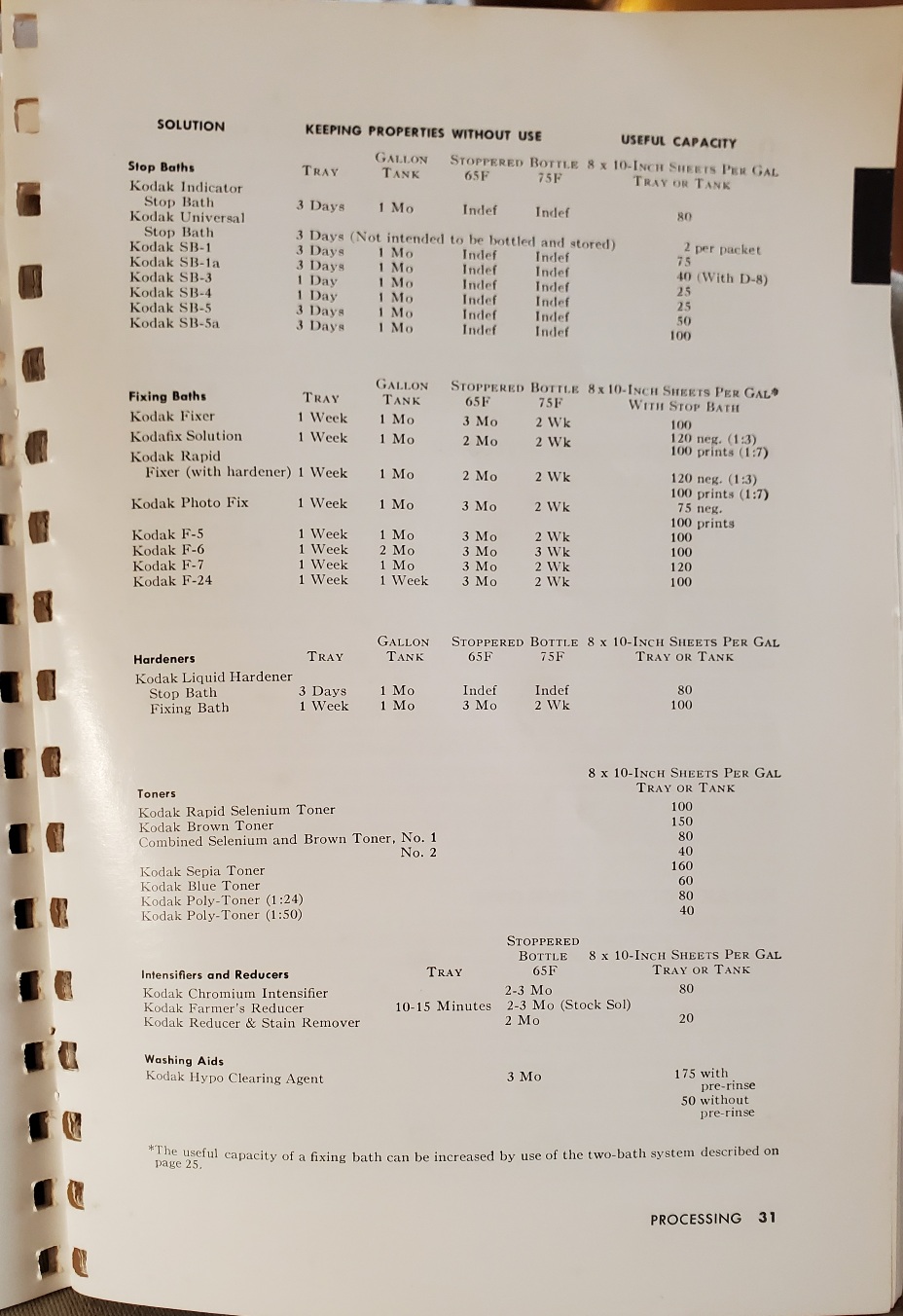

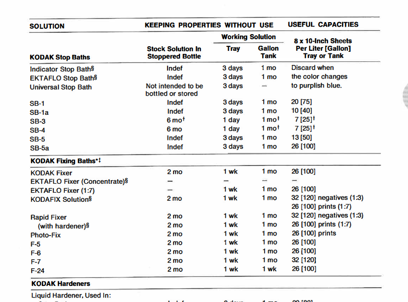

I've used this fixer on prints for a few months. It's cheap and easy to make.
Bottling at the end of a session and using it time and again.
My output of prints is not very big these days. Keeping the fixer for about two months before making fresh.
I have looked in few Kodak publications for information on how many prints a litre will safely fix. Nothing seems to be written down.
What is the limit of 8 x 10s I should put through a litre?
Thanks in advance.

Understood - but I use the Kodak Rapid Fixer hardener bottle B when I tone prints, and hadn't been able to find capacity information before - I just missed that on J-1.
