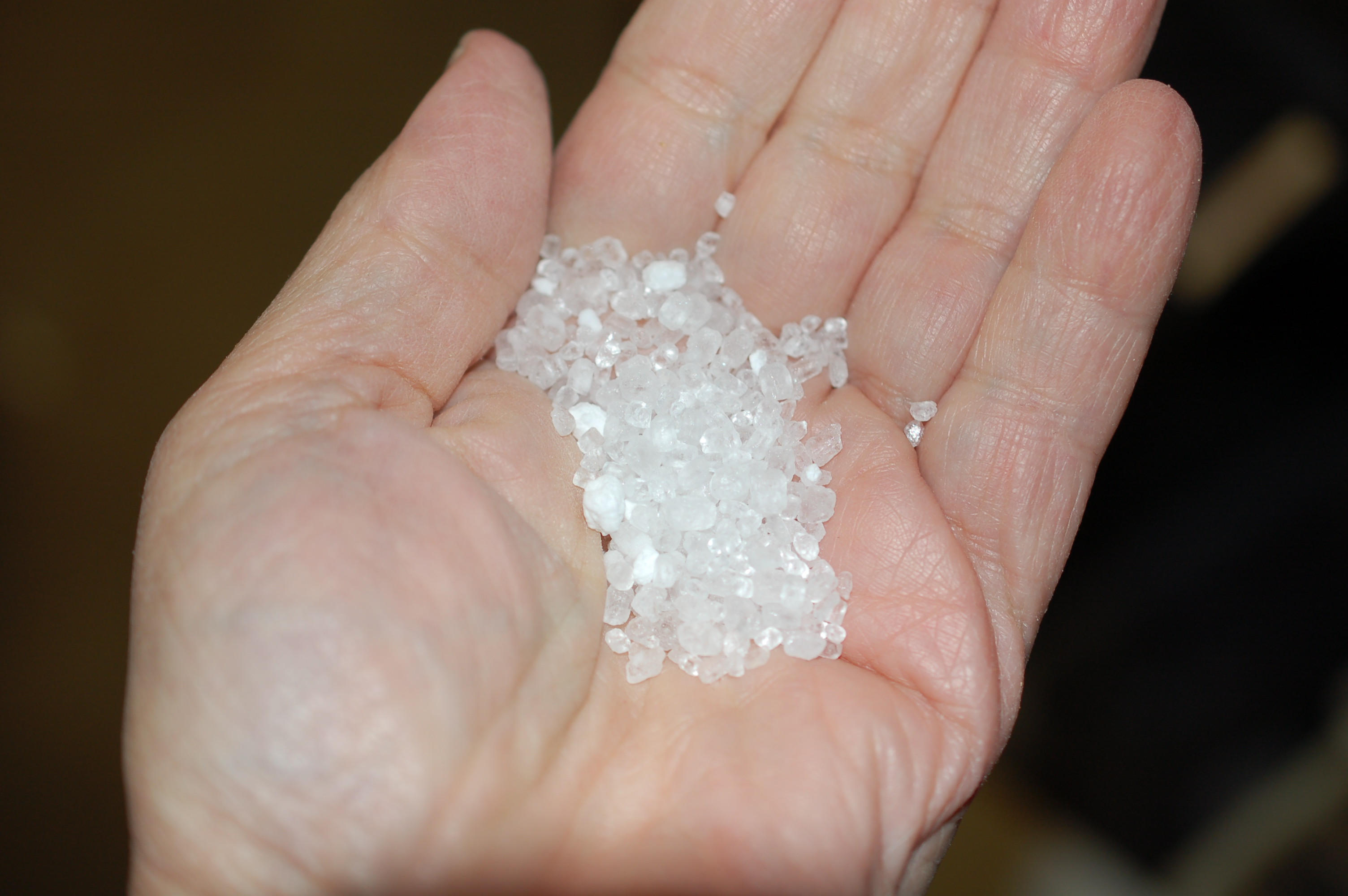

If you're using the original F-24 formula it would definitely be for the pentahydrate. This is how all the photo formulas were done back in the day. Hypo was the common name for the pentahydrate, that's how Kodak supplied. What you have isn't anhydrous anymore, clearly has absorbed some moisture.
I have a drum of the Kodak stuff (scared to go look at it, imagining one big block) but the stuff was "grain of rice crystals" aka pentahydrate. OK, I looked. It's in a drum, no liner, 30+ years old and mostly still good. I would need to sift it to get rid of the "styrofoam" on top. So I have 50+ pounds of plain fixer.
