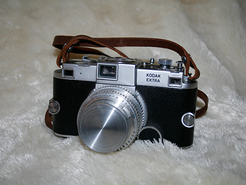

Here are some digi-snaps of the camera in question
First, is a shot of the camera, to verify it's identity.

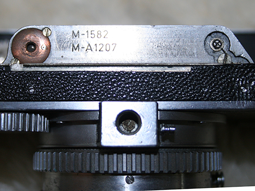

Next, there is a shot of the serial number on the casting inside the body, after taking the back off. Serial number M-A1207. The other serial number matches the one on the back.

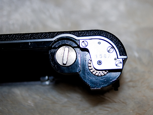

Third is the film back with a serial number of 1582.
If M = 3 and A = 2 then that means "32." Right?
Does that mean the date of manufacture is 1932?
According to Kodak's own website information, the camera was marketed between 1942 and 1948.
http://www.kodak.com/global/en/consumer/products/techInfo/aa13/aa13pg2.shtml
A date code of 1932 doesn't make sense. That can't be right. Can it?
I must be missing something.
