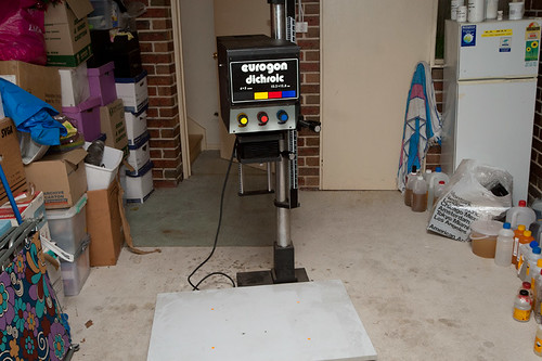

Colour balance at scanning?
I do not do my own scanning. I do not like to manipulate colour after I have shot. Thats the beauty of film.
Err no that is not the beauty of film, that is a misunderstanding. You cannot display a positive image out of a colour neg without colour balance. You are talking about it like it's a final product, which it is not. You can only do that with reversal film.
You are not allowed to judge that a film is "x colour" or "too red" if you just leave the colour balance to chance.
The same colour balance controls are found on an enlarger.
eg as on my enlarger;
Eurogon Dichroic Enlarger 2 by athiril, on Flickr
It must be colour balanced in the scan, or in the enlarger while printing. Minilabs scan the film and print. You cannot judge the film off a minilab, as it is completely unrepresentative, and the look is completely determined by the scanner not the film, look at this thread - (there was a url link here which no longer exists)
That is 160S and 400H, and a ridiculous of modification to contrast and saturation. Yet according to the OP, that is standard on the minilab scanner, as all optional changes are turned off. Don't judge by minilab results.
