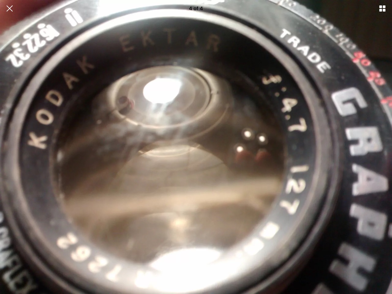

I bought a old 1945 Graflex lens and shutter to practice rebuilding on and wondered how to get the lens recoated and what does something like that cost ?

Thanks for the link. The lens I purchased may need just a good cleaning. The listing said it had something going on with the front coating. I won't have the lens until the weekend. The Kodak Ektar is an ER lens so it was built sometime in 45. Like you mentioned coatings didn't happen till after 45. I just bought it to practice on. I have done other Medium Format Shutters and having the tools to do it right, and I have a lovely parts cleaner and the shutter manual. I do think this shutter is actually for a graflex miniature. But they are all pretty the same. Worse case scenario I can use some of the springs if I need them for the speed graphic that's also on the way here.

If it has 'bloom' due to being an Uncoated lens, don't polish that away unless you can't get it cleaned up any other way. I had/sold a Zeiss folder that had a fair amount of bloom on the front element and it had very good contrast so I believe the claims of it being advantageous to leave it be.
I've "saved" some lenses that were otherwise too low contrast to be of much use with different grades of chrome polish and lots of elbow grease.

Try Windex and a clean t shirt. Just don't scrub it and scratch it .dab at it. I wouldn't spend a dollar on repairing that nice old lens. Use it the way it is or buy a modern lens from KEH or ebay.
