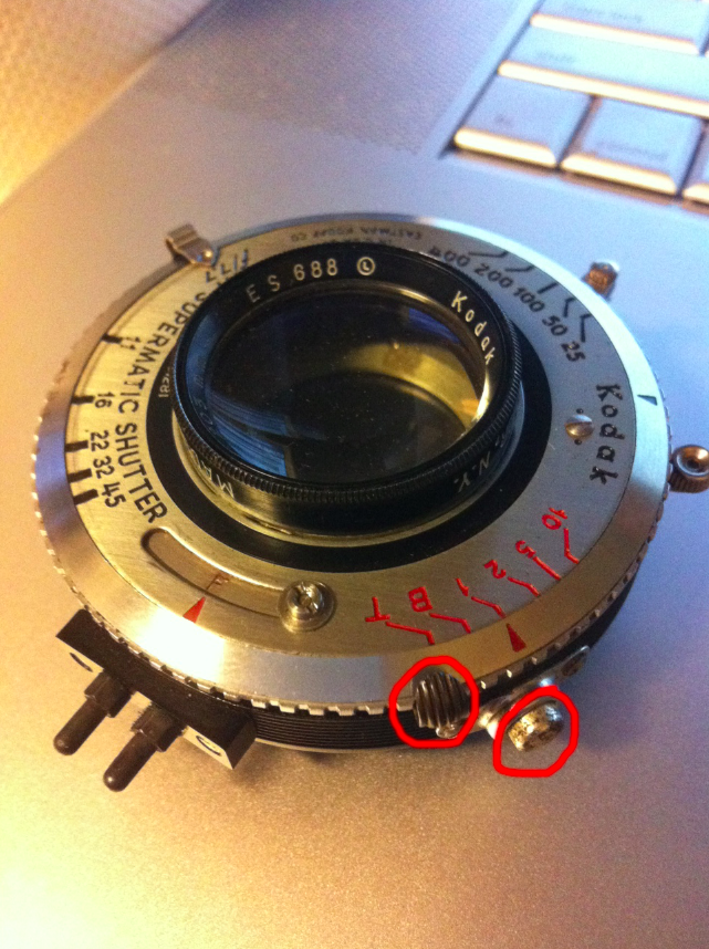

Hi,
Im new to this and just bought my first LF camera. It came with a Kodak Ektar f7.7 203mm on a Supermatic shutter and after searching almost everywhere I was wondering about two functions on the shutter (marked in red).
What do they do? The button is marked with an X on the back..
I read somewhere if I want x-sync it has to be set to F and with some easy modification I can turn it into X? How easy is it? Also read that set to F and fired with electronic flash the flash would be 1/3 to 1/2 stop down. Correct?

I believe it will fire on X-sync regardless of the M or F setting as long as you don't slide the other lever you've marked before firing the shutter. That lever engages the flash delay mechanism, which will be M or F depending on how the M/F slider is set.

The button is supposed to open the shutter even if its set to a speed other than B or T, for quick focusing.
There is a similar button on some Wollensak Raptars.
This does not work on the one Supermatic I've got though.
That may be because you're not using the press focus button properly. To use it, cock the shutter and then trip the shutter while holding the button in. To close the shutter, cock and trip again.

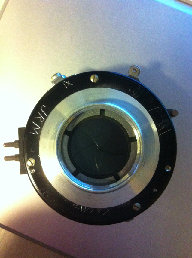

kameraobskura
May 25, 2012
5
Thanks for the info guys. Really helpful! :smile: now I just need a bipost to female hot shoe and I´ll be all set for x-sync studio photography.
The lens however is not missing its rear lens cell, I took this picture just after I removing it from the lens board :smile:
The flash delay level is somewhat stuck in "x-sync" and the shutter is slow on low speeds. I read that there is someone who does repair on shutters like this?

mine works on x synch with the thing set all the way on f
TEST IT to be sure--you want to be confident right--so when you get the synch cord (paramount is where I got mine) just fire the lens looking through it at the flash...if you see the flash through it then it's working...if you dont' see a full aperature or you see shutter blades, then you will have problems.

The button is used to hod the shutter open for focusing. Cock the shutter and press the button while also releasing the shutter. The shutter will stay open you close it by cocking it again.
The lever cocks the flash synchronization gear train. For flashbulbs, you cock the shutter, then cock the synchronization, then release the shutter. Without flash or for X sync, just ignore it (making sure it is all the way to the left as you face the lens).
