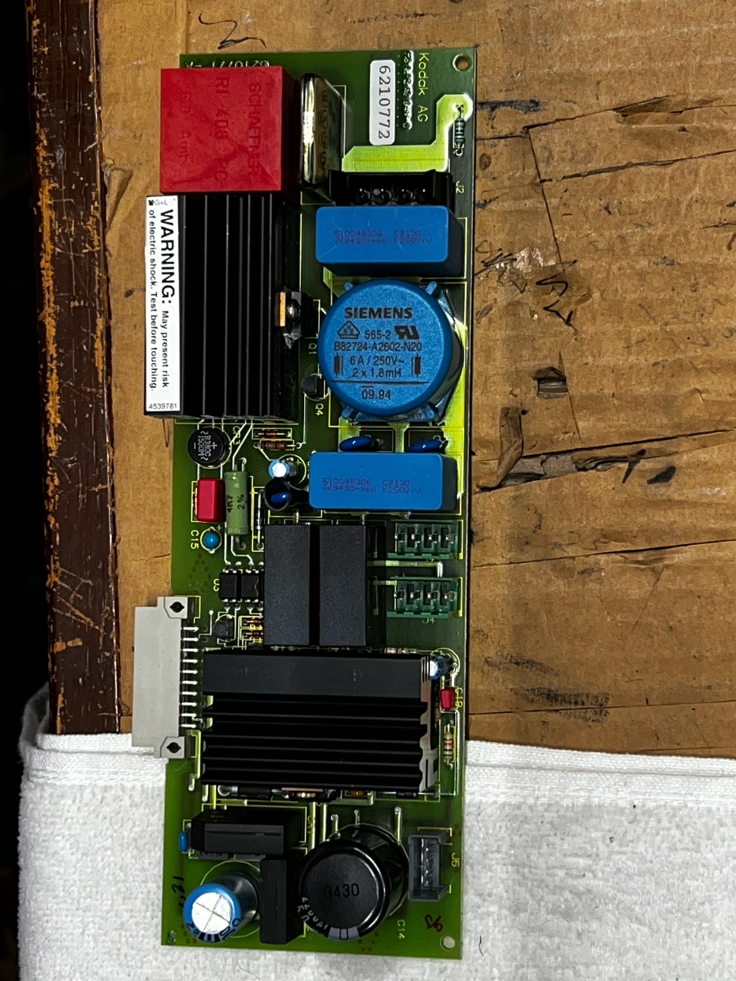

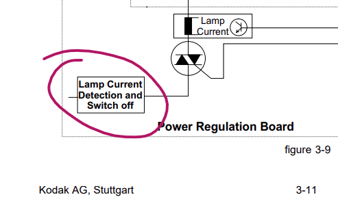

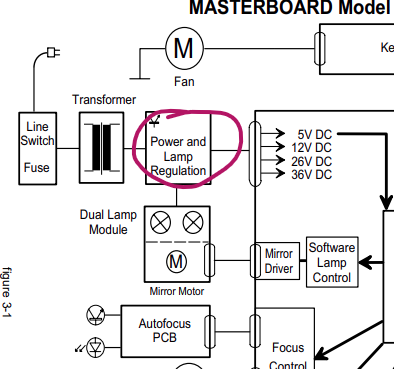

Your problem likely relates to this black-box functional module:
Physically, I expect it's located here:
If you can find a schematic of that part, it might be possible to come up with some hypotheses of what's going on. Might be something simple as a capacitor that's aged beyond spec.

Not really; I'm sure someone, somewhere has a set of schematics of this unit.
What I usually do in a case like this is isolate where the problem likely is, and then try to draft my own schematic based on some good photos of both sides of the PCB that I overlay and align, combined with some measurements on the PCB.
