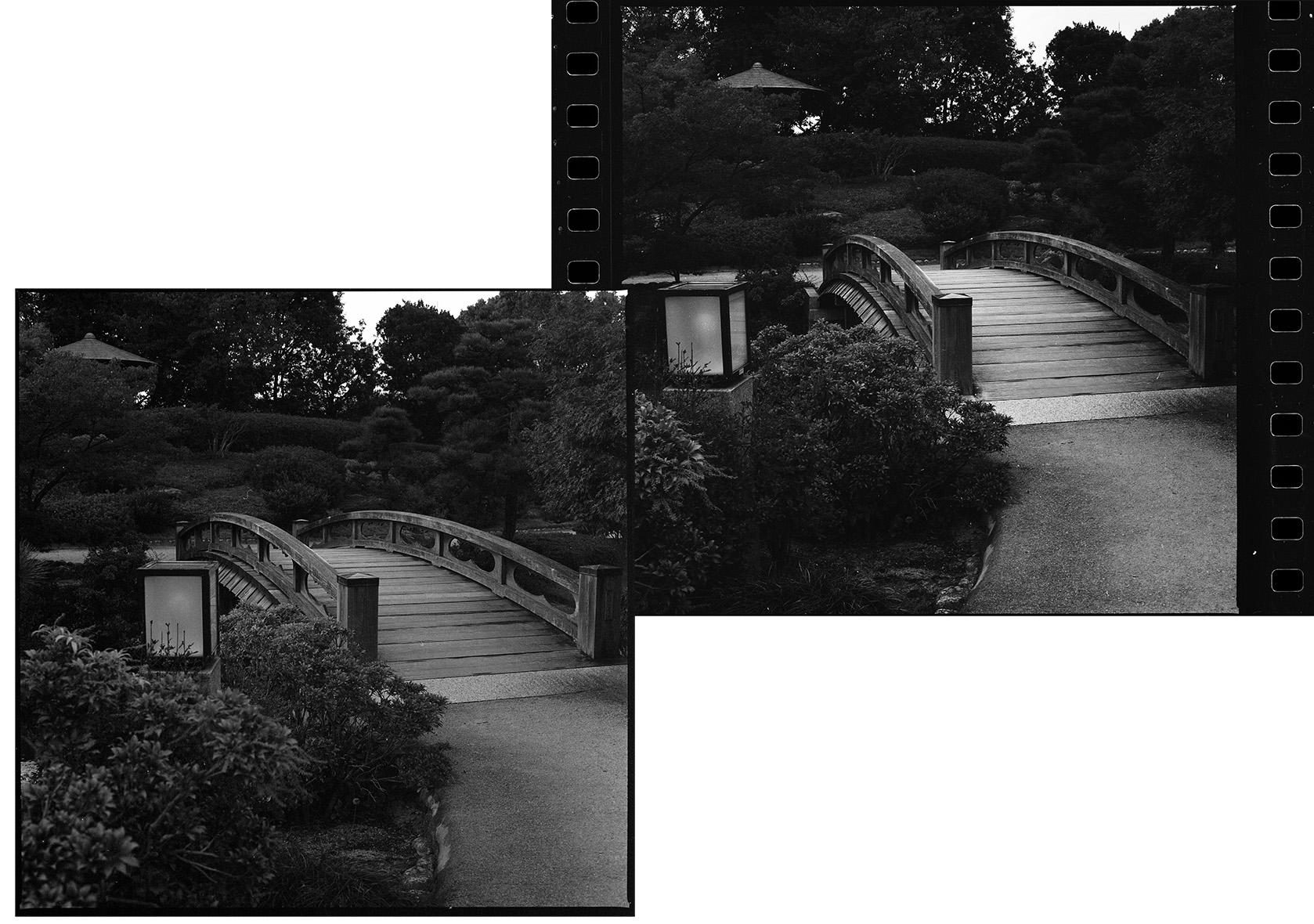

Found some interesting articles written by a film director Ryan O'Hara. Lots of details on Kodak B&W film stocks.
http://www.ryanpatrickohara.com/download/blackwhiteI.pdf
http://www.ryanpatrickohara.com/download/blackandwhitep2.pdf
And I found ONE photo on the internet comparing to Tri-X. Looks good!

Well, we all know marketing departments do all sorts of things to "make new product". Its hard to know how much difference there really is. Anyways, there is one guy on flicker who's posted some photos. Certainly a nice rendition of the bridge.
Would be nice to see some portrait shots, I guess that will fall to me unless someone else here actually has some experience with this film as opposed to reading off the Kodak sheet?

The Aerecon has extended-red sensitivity therefore a 2-stop filter factor with #25A instead of 3-stop. Hard to tell much from that comparison image since the contrast is different but maybe there's reduced green sensitivity. Maybe not.
Is this true of all aerial films?
Should I be using a red 25 filter with a 2 stop adjustment on my GAF aero film?

Haze reflects blue light and so extended red sensitivity is needed to see thru the haze. So I would say yes all aeriographic films have this property. This can be seen from looking at the spectral sensitivity curves for the films.
