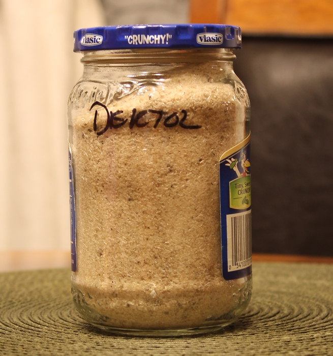

Here's a picture of oxidized (old) Dektol. I don't have any old D-76 on hand, but I would expect it to have a very similar color. This amber/brown color would also appear in mixed developer. This came from an old paper/foil bag.
