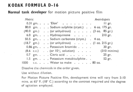

In Kodak Chemicals and Formulae (1949) it lists the recipe for Kodak Formula D16 with the description that it is a "Normal tank developer for motion picture positive film" however apart from it being mentioned in passing in one post here on APUG ((there was a url link here which no longer exists)) I have been unable to find any other reference to it either on the internet or in print. As it is not listed in the 1946 Kodak Handbook I am guessing it was introduced around 1948/49 (?)
I am looking for information on this developer relating to what films it was intended for and whether it was a standard negative developer being used for Neg-Pos transfers or if it was for use in a direct reversal process. Other information such as whether it is suitable to use on modern films and what characteristics the developer has/had when used as intended would be appreciated too. Attached is the developer formula from the book.

"Motion picture positive film" usually refers to release print film, the stuff that gets run through the projector. As such it is still a negative process, not a direct positive process. It's the equivalent of paper in traditional still photography. So this formula is likely to be more like a paper developer than a film developer... for whatever that is worth.

It really would have surprised me if it was a reversal process, though there are a lot of guys on here who have forgotten more about analog processes then I will ever know and things can sometimes be suprising...

The ratio of metol to hydroquinone seems unusual: in the formula given it's roughly ~1:19, (unless there's a misprint).
I think that would make it a rather contrasty developer?
(aren't most "normal" MQ developers in the 1:2 - 1:6 range?)

Aren't motion picture positive stocks purposely low contrast? Wouldn't this defeat the purpose of making the stock low contrast? Also for comparison D76 should be 2:5 ratio of metol to hydroquinone...

I have no idea about MP stocks. I'm just pointing out something I observed about the formula :smile:
