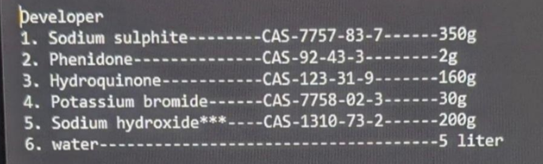

Normally I've used this developer here for b&W reversal of paper:

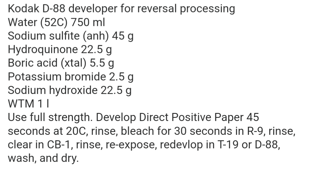

However, I've just tested a formula for Kodak D-88, it works, but now I want to understand how it works without any metol or phenidone.
How does the boric acid come into the mix?

Doesn't look like a fogging developer going by the ingredients and the workflow in the screenshot (fogging dev would replace re-exposing step).
Hydroquinone works as a developing agent by itself at higher pH.

Using hydroquinone alone creates higer contrast than the P-Q combination. This effect was also used in Kodak's D-8 super high contrast developer for direct positive film.
It creates a borate buffer together with the hydroxide. Although given the ratio between the two, the pH must shift all the way to the upper end. Not sure if this is the only or main reason why it's in there, but I'd expect so.
PS: it helps if you quote text from their original source because it preserves context. E.g. the D-88 formula you got from here: https://www.photrio.com/forum/threads/kodak-direct-positive-developer.31512/ In this case, it gives essential information about the "fogging?" bit because it's mentioned as a developer for direct positive paper, and post #5 in the thread contains essential information on that aspect.
As to why hydroquinone on its own gives 'high contrast' (the question is what is exactly meant by that - high dmax or cutting off of shadow detail?) - I suspect you may have to refer to the literature and that the underlying chemistry might be complex. You could start in e.g. Mees; https://archive.org/details/TheTheoryOfThePhotographicProcess Chapter XI might give some clues.
The D-88 formula do look like half strengh D-8 though, albeit less bromide and added boric acid
A borate buffer is interesting. I'd imagine the precision on the amount of boric acid would be fairly critical because of it and the pot bromide are the only inhibitors I see.

The exact formula I used was a pinch different to that described on this website, but virtually the same.
I can definitely say after comparing strip tests that D-88 is certainly higher contrast than the other Dev I've used.
