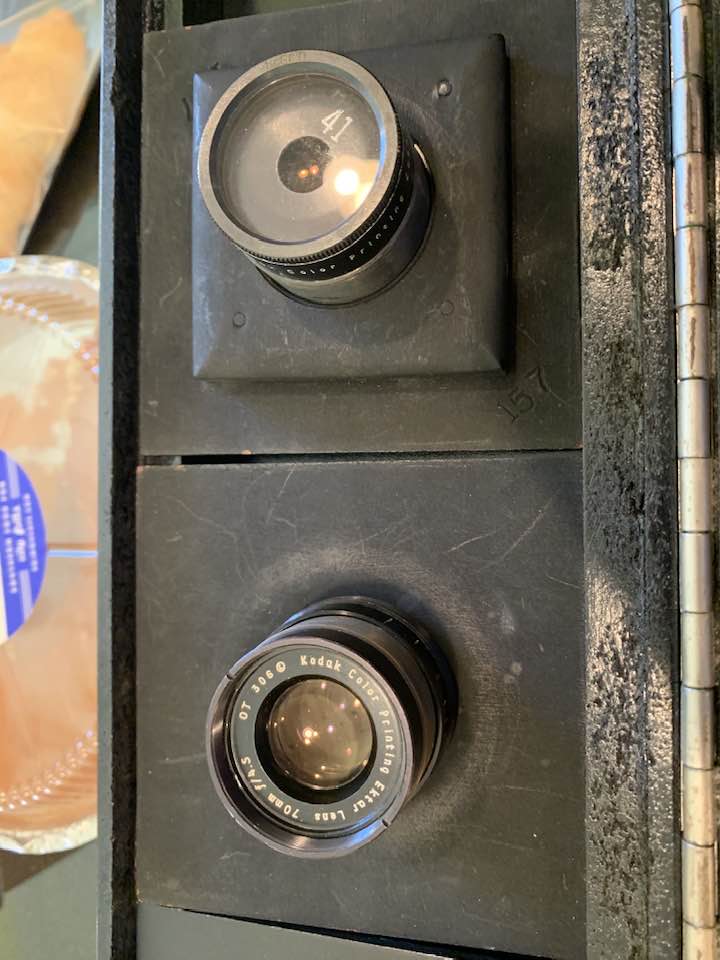

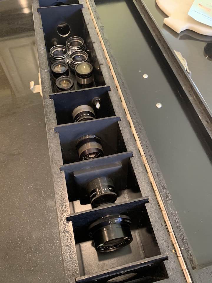

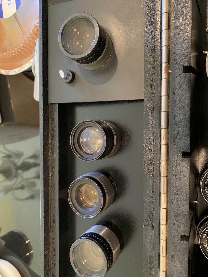

It would be interesting to see what the lenses look like, any chance of a quick photo. Does it have aperture blades ?

Interesting that they used stop washers, thanks for posting the photos. I don't think these were exported to the UK/Europe, there were some items never imported, and in reverse we had some Kodak Ltd items never sold in the US. When I began (late 1960s) there were developers unique to the UK & Europe, Kodinal (Kodak's version of Rodinal had just been dropped, we had D163 not D72/Dektol, and so on.
