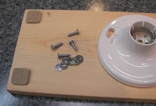

These have the same screw thread as a standard light bulb. You need to find a free standing lamp that it will fit in comfortably (no conflict with the reflector or any shade) and just screw it in and turn it on.
In days past, it wasn't unusual to have light fixtures in a ceiling that were just a simple socket pointing down. These Brownie lamps were perfect for those.
By the way, it is the amber cup that you will use for most B & W papers.
EDIT: here is a picture of one of those ceiling fixtures
