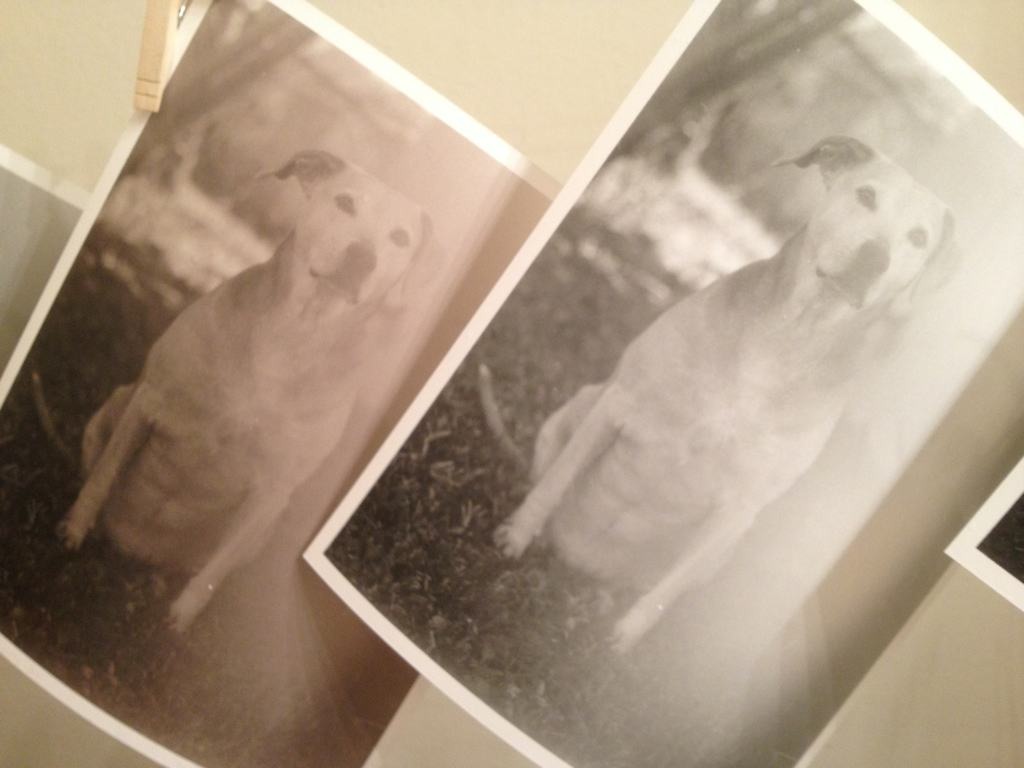

Why have I waited this long to try this?!? I. LOVE. IT.
ChristopherCoy
ChristopherCoy
Aug 9, 2011
3,602
On a boat.
I thought it was going to be a lot more complicated than it was. I've gotten to a 7th and near final print, which ill scan later on. I think I definitely prefer the brown/warm tones than the cold tones.

I diluted 1oz into a 1L of water.

This thread cracks me up! I just tried this as well! I posted a shot in the gallery, but here:
I also did 4 minutes in selenium too.
