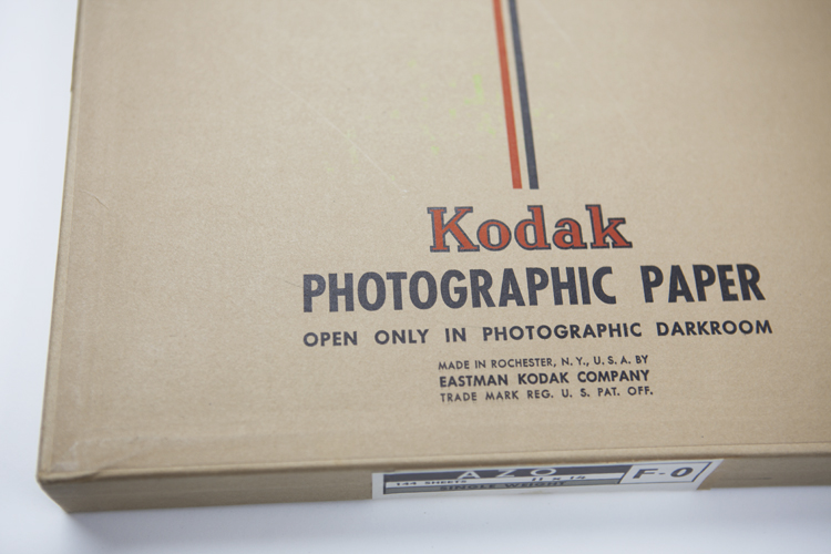

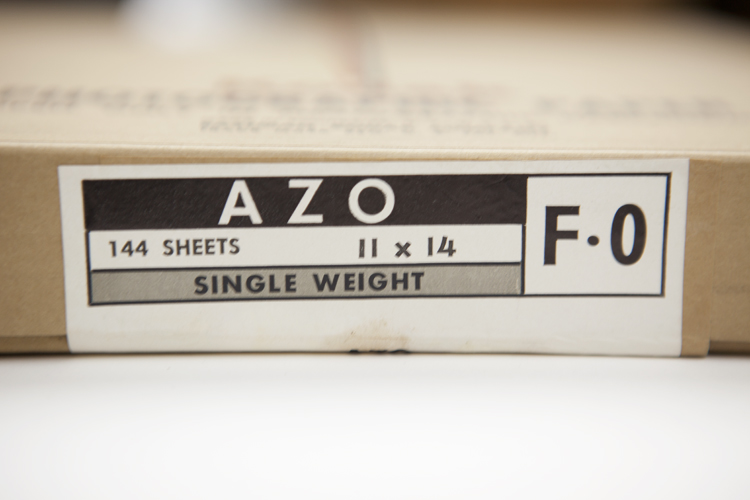

Hi,
I have a question I was hoping that someone could help me with.
I own a box of 11x14 Kodak AZO paper (F-0). The box is in good condition and unopened, holds 144 sheets.
Can anyone give me an idea what this might be worth? Also how do I tell the age of the paper?
Thanks for your help!
Gordon
jgjbowen
Oct 13, 2003
879
Richmond, VA
For someone who has some VERY contrasty 11x14 negatives it COULD be priceless. But as someone who would pay top dollar for a few boxes of 16x20 or 20x24 Rochester Grade 2 Azo, this grade 0 11x14 is worthless to me.
My best guess on the age of the paper would be from the 40s or 50s.
My suggestion would be to post it for sale on the Azo forum and see what develops (pun intended).

I don't remember exactly, but it seems to me Kodak began the move from packages of 12 and 144, to 10, 25, and 100 around 1950-1955. Agfa and others followed along soon after.
I have always thought it ridiculous to sell sheet film in boxes of 25 which means one can load 12 holders and have a sheet left over in the box. Paper was boxed in the same quantities as film.

old Azo can surprise you
I have a box of 5x7 Azo with an expiration date of 1941 and it prints perfectly. On the other hand, I have some 2003 Azo grade 3 that prints a little dirty, especially at the perimeter of the sheet. My theory is that the older the stuff is, the longer it lasts. However, Grade 0 would be pretty much useless. One would have to make some negs suited to it: develop in Dektol or D-19 until the neg is bullet proof. Then you might get something really spectacular on the Grade 0.

John,
Wasn't planning on using it for pinhole. Actually I don't think that I am going to use it at all. For the type of photography I do I wasn't sure if I could appreciate it. I was thinking of selling it to someone who would make better use of it.
Question for everyone, I know that a grade 1 would be better but would it be much better than a grade 0? Is it much more useful?
