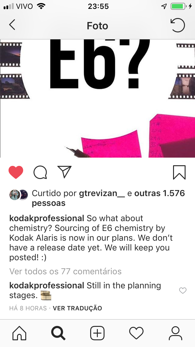

Kodak posted this on their @kodakprofessional profile on Instagram:
Maybe they will just get it ready from Tetenal (if the employee’s plan works out) or they will make it themselves.
Let’s see what the future holds,.
