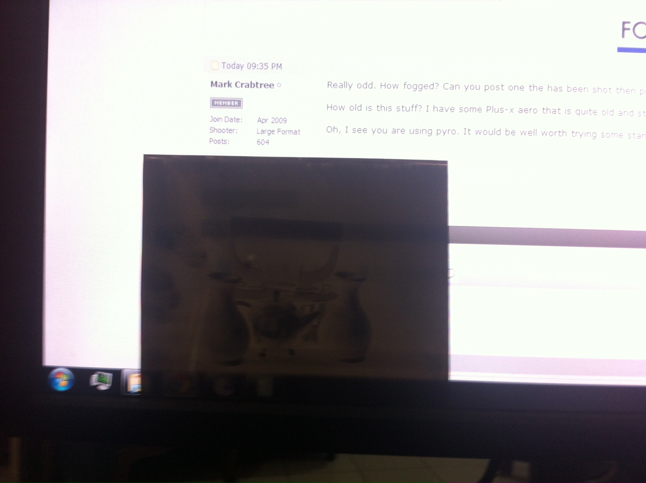

Yes Mark I've tried several developer like rodinal, d76, and few others, still got the same photo.JPG
a month ago still got normal result.
