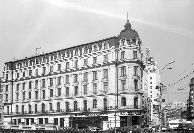

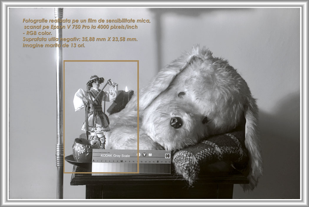

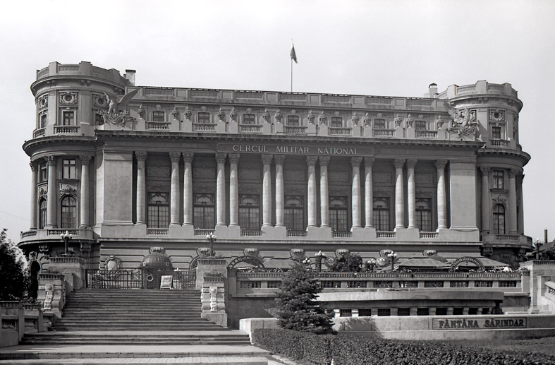

I have same tests with B&W positive film in-camera like negativ and slide.
Negativ have 3 - 4 ISO – see images.
Slide have 50 ISO.

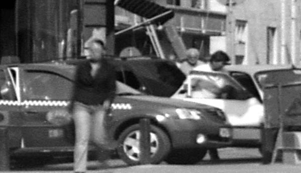

Michel, B&W positive film in-camera like negative have only 3 - 4 ISO and a spectral sensitivity very little and is incredible the images you see with the positive film. I like the quality of images and I work very much for discover the developer and the parameters. Is not an easy work, but when I see the pictures I can go before. If you want see the crop with picture of dog: http://membres.lycos.fr/georgegrosu/11 inalta rezolutie.htm .
B&W positive film in-camera is difficult with peoples (see pictures).
With the reversal processing me don t has a similar quality like the negative processing (for B&W positive film), but I have a good sensitivity (25 – 50 ISO) and I think I can change same think. Reversal images are not bad, but the scan is not good.
