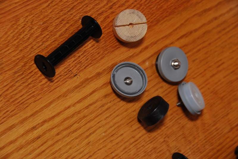

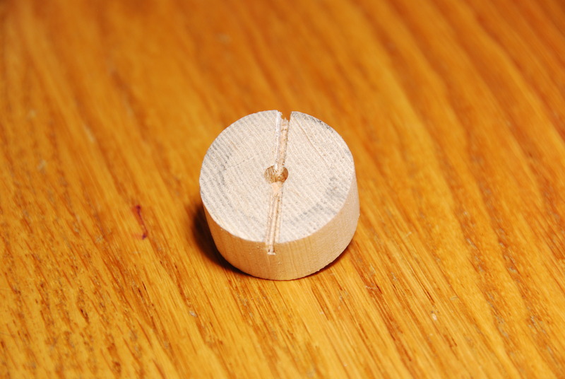

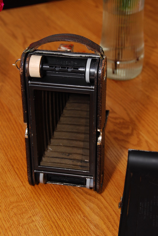

Here's how I modified mine. I've created three spacers from leftover 35mm film canisters and bolts and nuts. Just trim the canisters, poke a hole in the center and run a bolt through. For winder, I created a winder spacer from a wood dowel with a short metal piece (see pictures). I wind by simply counting number of winds. Makes a great panoramic camera.
