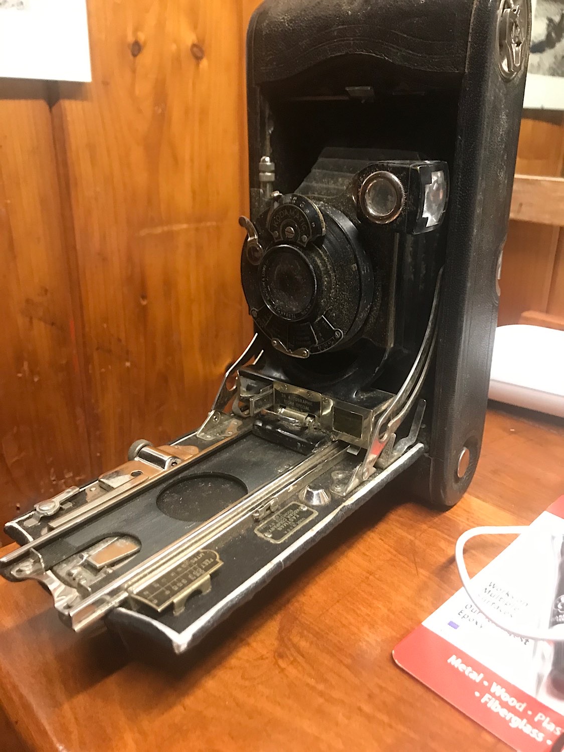

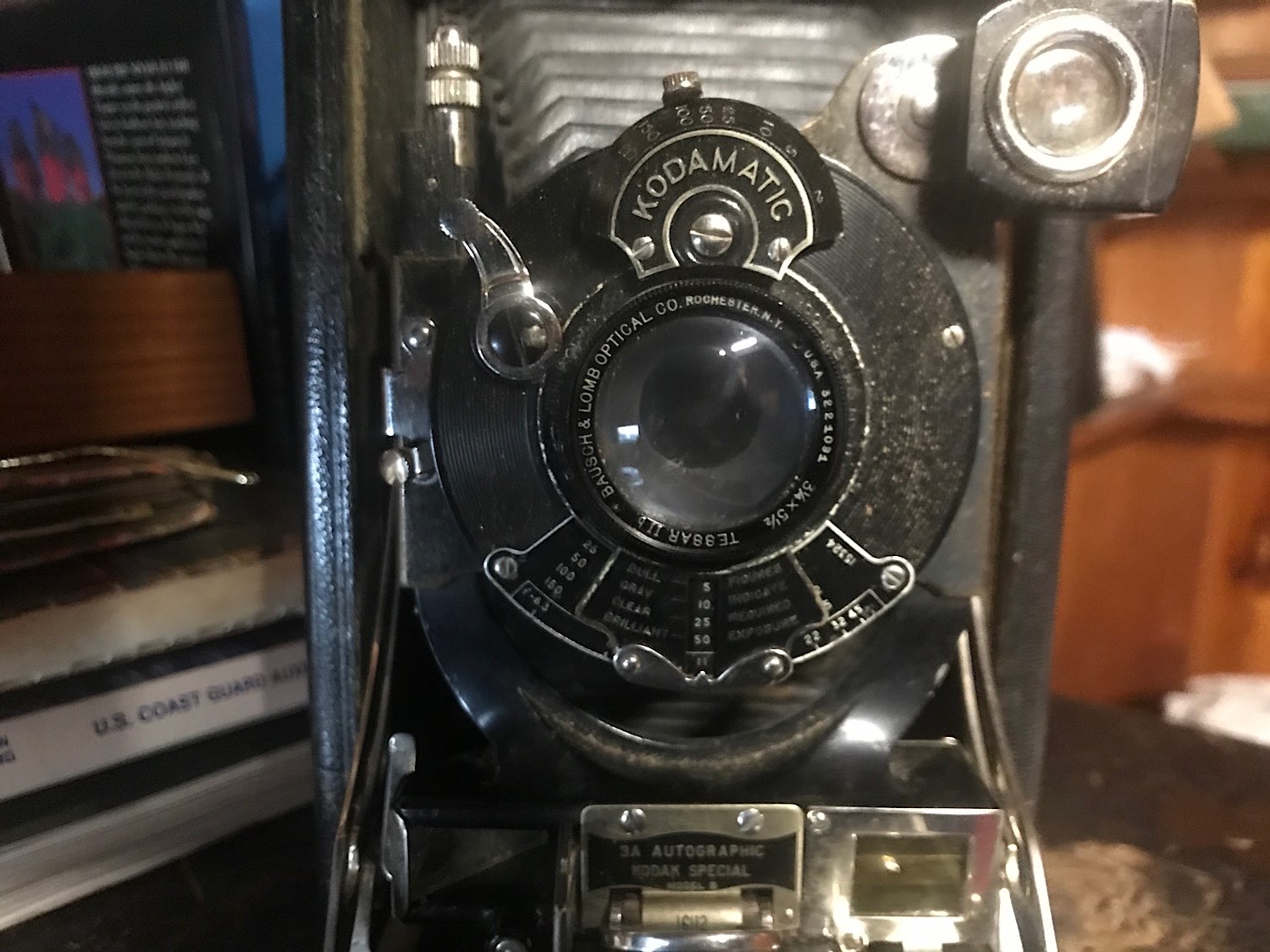

I just came across my father’s Kodak Autographic 3a Model B rangefinder....with a roll of film inside. I pulled the D-ring under the lens and the bellows/lens assembly came out smoothly, but trying to slide back to close, it is hung up at the beginning of the door’s rails, there is a gap between that and the short rails in back. This model does not have the two clasps to squeeze to unlock from the slide, and I cannot find anything else.
Would love to use this camera, the lens appears relatively free of fungus and although there is a lot cleaning to be on the exterior, my first impression of the bellows is they MIGHT be OK. Unfortunately the film appears unused, would love to have found old images. I thought I was rewinding until I Finally saw the frame numbers and stopped at 5. The second photo shows where it is hung up.
Thanks in advance!

Turn the focusing knob (on the camera's right side of the bed) to fully retract the rails and the front standard should then slide back into the body.

Thank you both! I had to pull the focus knob out before turning, but figured that out.
I wonder if I can unload and rewind the film back to the beginning without fogging? In. dark room with filtered red light.
Now to look for 120 adaptors or film plates, this model does not have the plate focus panel, only the roll film focus guide.
