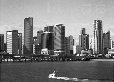

The problem can easily be seen in the photograph below recently made by William Wetmore. I appreciate William allowing me to share this example with readers. You will notice the word Kodak clearly appears in the sky, along with frame number '13' multiple times. I first became aware of this situation a few months ago when a former workshop participant brought some online discussions on this topic to my attention. Unfortunately, as time has passed, I have encountered a number of students, colleagues, and friends who have experienced this exact problem.

I have spoken at length with Thomas J. Mooney, Film Capture Business Manager at Kodak Alaris about this phenomenon. He told me "Kodak Alaris has had a limited number of inquiries for similar problems, and that the affected film may have seen some abnormal keeping after it left the factory (e.g. sat in a truck over a hot weekend, etc.). That said, we are taking this issue very seriously and have recently made modifications to the backing paper which we believe should minimize the potential for this type of blemish going forward."
Mr. Mooney has supplied me with the emulsion numbers - which I have listed below – where this latent image print issue could potentially be seen. If you have experienced problems, or have questions or concerns, you should email Profilm@Kodakalaris.com. This email address goes directly to Mr. Mooney, who will be able to answer your questions, address your concerns, and replace any problematic film you might have on hand or have used.
If you purchase new film you should make sure that the emulsion number, printed on the box as well as the individual foil packages, is higher than the suspect emulsion numbers listed below. All photographers can imagine the disappointment and frustration any of us would feel if this happened to any of our negatives. Please pass this important news on to your photographic friends.
John Sexton recently released an article in which he explains that this is a manufacturing issue at Kodak with certain batch numbers;so,nothing you did wrong.
