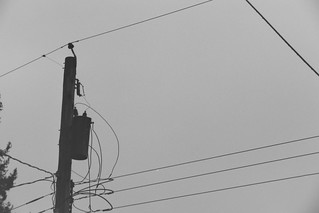

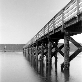

If I was going to develop it in Rodinal I would do Semi-Stand in 1:100. I have had good results developing Kodacolor-X in my own Beerenol recipe:
Gun at Illahee State Park by Bryan Chernick, on Flickr
Illahee Pier by Bryan Chernick, on Flickr

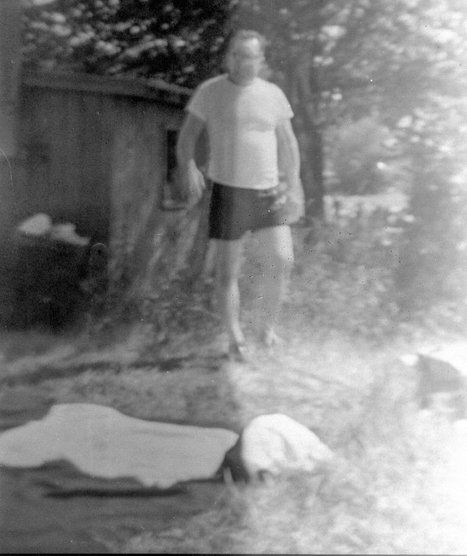

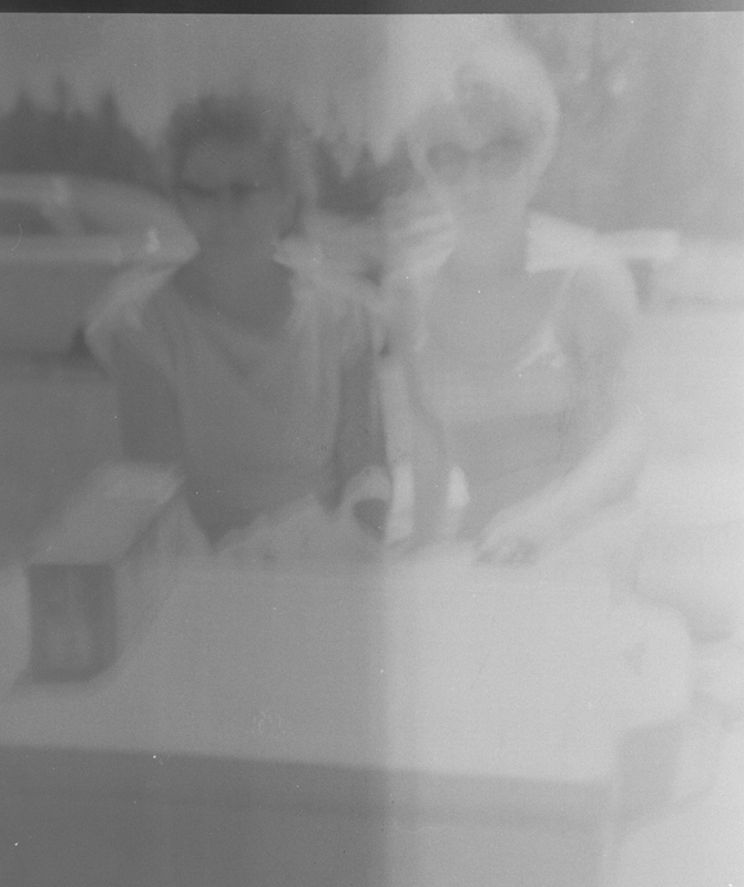

Ok...here are the results.
This roll had only 4 frames exposed on it (that I could see, anyway). Only two of those frames produced images.
Bad images.
But it was fun (I'm still grinning) and an experiment. The negatives were extremely thick (dark) with a strong orange cast. They developed with half of the frame darker than the other which tells me that I probably should have doubled the 'Beeranol" recipe I followed from BAC1967 and will use it again should I come across more old, old film. Considering that this roll was exposed around 50 years ago and has set in the camera subject to unknown environmental changes, I am very happy to have gotten anything.
And this is what I got....
Anyone with suggestions, your comments would be appreciated. Also, if you are able to date the images from what you see, please post your best guess.
Thanks...it's been fun
Ken

Way to go Ken! I would say that car in the background is your best hope of dating the images but it's hard to tell what it is.
