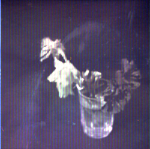

you can check out the thread I made on quick n' fun color screens in the Alternative Process forum, I am constantly looking to refine these. my goal ultimately is to be able to make an attachment that would work with any old camera on any old B&W pan stock.(heck I'll sacrifice a little quality for that) I have attached a few images here that I made using (photo paper!) recently using a 120mm Kiev camera w/ green filter and red mesh. Now heres the fun part, originally I was scanning these in through a similar mesh/filter arrangement but the colors were pretty dull. then I found it best to do a digital intermediate process making separate CMYK layers. I then print these out at the local Photo Lab. as you can see classic color discrepancies are very apparent, and totally lacking red info, any reds are more like violet. Unfortunately, I get all my film & supplies from work and we mainly use 16mm and I haven't had the time to go to buy my own, i'm limited to 16mm tri-x reversal, orthro 35 (asa 3!) and a whole bunch of photopaper. I think maybe on nice pan 120mm rollfim I can start to more promising results. please excuse the pics as there a bit hastily done, and the mesh had a tendency to wrinkle just look at the bottom left corner of my backyard snap.

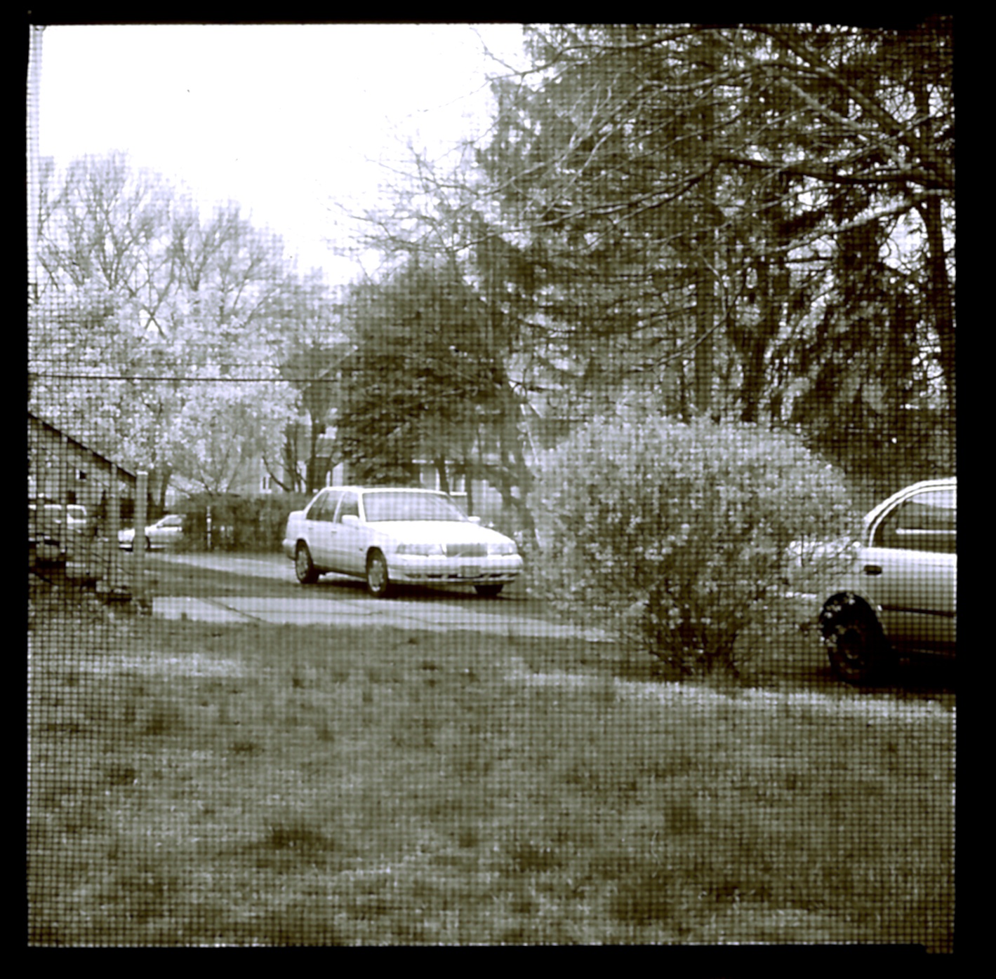

as much fun as additive screens can be, I personally prefer bi-packing! as these are my best results in so far with the 2 cent mesh/green arrangment.

I admit, I don't get how the mesh arrangement leads to color reproduction. Can you shed some light on the matter?
The still life is really awesome. From my screen plate experiments, that rainbow-y look is very familiar, and I also know that the right colors can pop when the registration is spot on = Awesome!

i'm by no means an expert on color theory as my knowledge lies mainly in motion camera operation & lighting. but i do believe its works in a similar manner to early additive color screens like those made so popular at the turn of the previous century, except my matrix is only made up of red and green. if you want a sample of the same mesh I use I'll be happy to send one over to you as the postage costs more than the mesh, just let me know what film format you need. I use a green (X1) filter and some gaffers tape to secure the mesh on the back of my Kiev 88. i like to call it "magecolor" magically turns b&W to "color":smile:

For one, true color reproduction is impossible without panchromatic b&w film/paper. But I suppose 2-color results are possible with orthochromatic emulsions, in which case you'd need to use blue & green, as the red will have no effect.
Is the mesh transparent? Obviously it has holes, but if the threads are dyed red and yet are not transparent, it will just act to block the light and not necessarily modify or separate the red light.

agreed, hence the magentas. anything yellow or red comes out black and simply acts as an"off" gate in not allowing light to pass. notice the bush on the right, its supposed to be a nice yellow. fortunately I'm off for the holidays past tomorrow so I'll be able to work on the lenticular system (using tri-x on that one) just curious, have you ever done in-camera bi-packing/tripacking? it is by far the easiest and in my opinion most reliable for method color reproduction. these quick color screens are really more like a hobby for me (like building rc planes) as I'd never actually show it to my clients for obvious reasons.

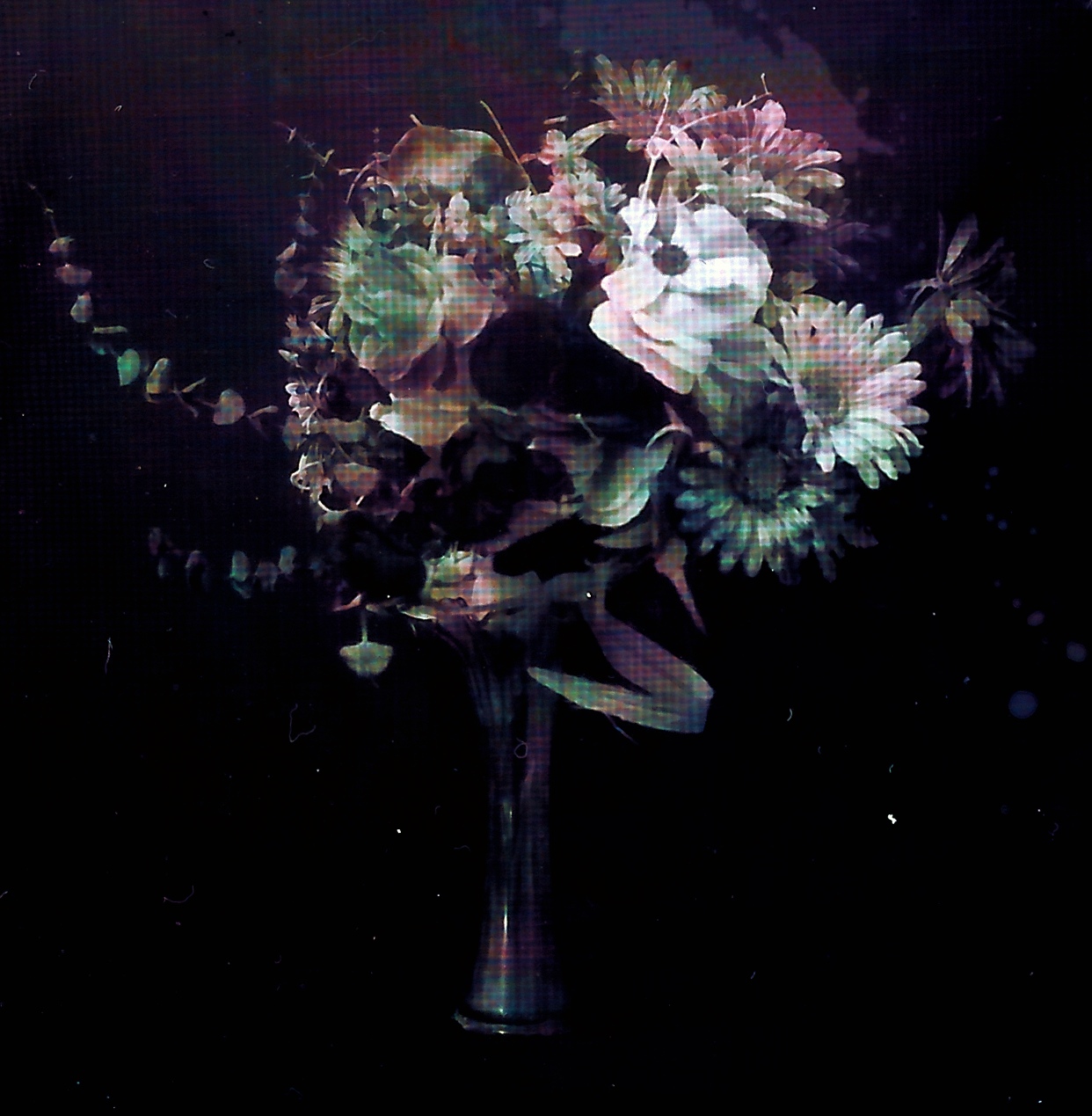

kodacolor mixed results...
had some time over the holiday weekend to finally take snaps of the Psuedo Kodacolor Process 1. As you can see not the best. The second attempt worked a bit better than my first trial (whole trick is too have a fast enough lens to for the tricolor filter to work) It is very tricky as far as registration goes. Also the vertical lines are quite noticeable. I need to get my hands on a more "serious" lenticular screen. One thing I realized was that I had to adjust the colors of the tricolor filter to better suit the film which took some trial and error.
