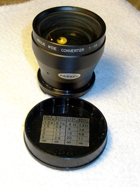

I inherited a Argus wide (must be video) converter 1:1.8 6.5~26mm. I'm wondering about the "X" factor. I'm thinking it's a .75x multiplier, but I don't know and I can't find anything thru Google. Any ideas?

Here's a picture. The converter has 49mm female threads on the back and is made in Japan. 6 glass surfaces from what I see by way of reflections.

sounds like an attachment to R8 or S8 for argus brand consumer film cameras. what type of mount does it have, any pics?
not 8mm for sure!!! that looks like a wide converter maybe argus-cossina slrs, 70s? could be wrong...
argus-cossina wasn't the only one with 49mm screw mounts for 35mm SLRs there were various other models by other brands, Sears etc; it converts a medium lens down to a wide angle. in which case you divide by the given ratio on the lens: 1:1.8. Thus on your 50mm camera lens if your focus rings says 20' its really 11' with the converter on (20/11=~1.8) or on the opposite end 4/1.8=2.222 etc; which is rounded up to 2.3'.

The inside cap of the converter has a chart which gives the focus distance as explained by you. I'm confused tho as to how that translates to field of view.
you'll get a more macro fov. it nearly doubles your field of view but changes your dof as well.

Ok thanks for posting the picture. Looks like it is to go on a normal lens for a 35mm camera as a wide angle conversion. The fixed lens 35mm rangefinders (Konica, Yashica etc) usually had these as add-ons. The one you have may work on other formats also*.
If you don't have a camera with a 49mm thread, can't you just hold it up to the front of the lens and see what it does?

I've actually had it on a lens and on a D camera to see what was up with it. I'm thinking, and have yet to prove, that it's giving me a 42mm fov, but I don't know if I'm figuring that out correctly. I'll have to compare it to my 35mm Nikon lens today I guess and see. I was just really wondering how you figure the fov out mathematically.
i'm not too familiar with D cameras, from what I gather from camerapedia they usually have a 68mm equivalent lens, so 68/1.8 is ~37.777. If so for 120mm format you'd get almost twice the field of view as you'd normally would get, for example my Kiev uses a 30mm Zodiak 8 wide-angle lens attachment. They [Dianas] do accept 49 fem adapters don't they?
