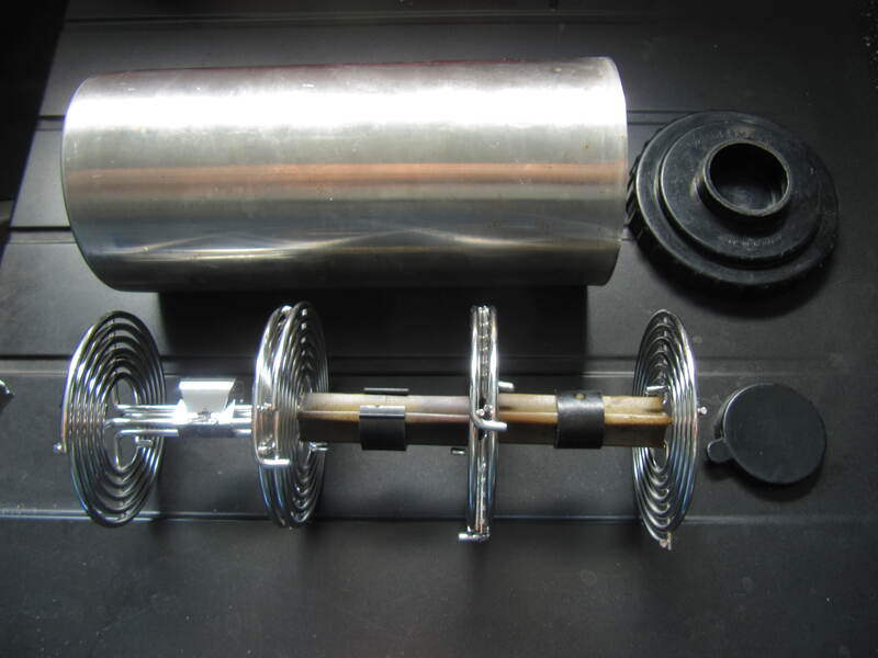

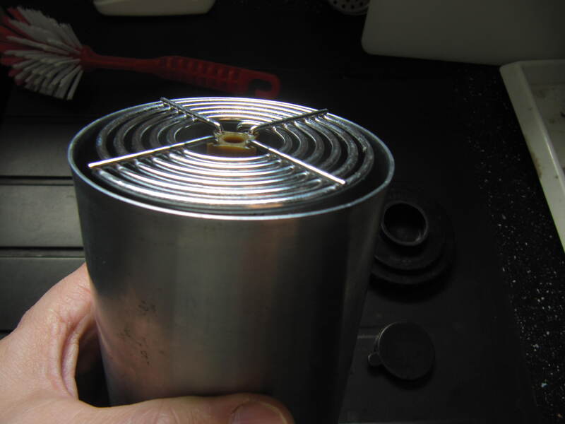

I bought a Kindermann with 3x 120 spirals. But I am wondering if it's a correct combo or maybe that tank was supposed to be used with 4x 35mm spirals.
As is with the 3 spirals correctly stacked, the top spiral is by the brim, and filling needs more than 1liter but ~1,1liter, which means more than the default volume of usual C41 kits, at least in the metric part of this world. For BW no problem if I use HC-110 but Foma powder kits are calculated for 1 liter solution.
The height of the tank is 195mm.
I have searched google.de in german with "Kindermann Entwicklungsdose" and extra combinations of keywords (120, Größen, Stahl,...) but found no docs.
this is what I have:

That looks like a correct fit for the reels in the tank, assuming the lid doesn't have parts that project below the top of the tank body.
The diameter of the tank is determined by the size of a stainless spiral that can hold a 36 exposure roll of 35 mm film, which is about 159 cm. The 120 can use heavier wire to separate the wider film, because it needs to hold only about half the length, but there's no way to shrink the height; the film is 62 mm wide and there's no changing that. So, including the thickness of the top and bottom bracing wires, those spirals are roughly 68-70 mm tall, which determines the inside height of the tank. Half of diameter, squared, times pi, times height is volume.
So, we've got a minimum diameter determined by one film, and a height determined by another, and a compromise set of dimensions determined by wanting to put both in the same tank to save money -- and an original use case in which a photographer would typically either use one-shot developers, mixed from working solution or concentrate to the desired final volume, or would keep a relatively large quantity (often 2.5 to 5 liters, if not more) of replenished developer on hand, use it as needed, and replenish based on how many films were processed. C-41 was never really intended for hand processing in "small" tanks like this one; it was made for replenishment in processing machines that would either run dozens of rolls at once in much larger tanks than this, or would run the film more or less continuously, one roll behind the other, for an entire shift.
The kits we get now are really aimed at users who'll handle one or two rolls at a time, and for that, 1 liter is plenty. Until you get a tank like this and need to process three rolls of 120 at a time.
For B&W, the solution is fairly simple: use diluted developer, one shot, and discard the used solution; mix more as needed. Your fixer can be diluted 10% and you'll never know the difference; it'll still fix the same number of films and there's enough safety factor in the recommended time you'll still get fully fixed film with 10% more water in the solution.

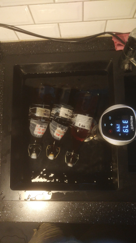

yes, in my experience accordion bottles are bs. The discussions about oxidation of chemicals are endless like byzantine theology, but in my experience 1liter C41 chemicals with a little bit air under the cork doesn't make a difference for a couple months.
Thick glass bottles with flip-tops are solid, convenient to handle, easy to pour fast into a funnel over the tank and back. I immerse the bottles in a sink full of water kept at temperature with a sous-vide circulator.

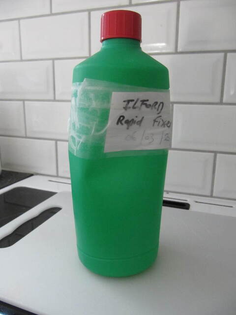

Otherwise I use also cheap plastic bottles used for domestic bleach/chlorine/ammoniac, they have an effective safety screw cork, and seem to be not porous over the time, or not significantly. I buy some, like 1€/$/£ each, throw away the chlorine or ammoniac, wash and rinse thoroughly. I typically store BW fixer in them. Compress a bit the sides to get the chemical to the brim before I screw the cork. They stay compressed in the given shape, do not move back.. Here for instance one liter Ilford Rapid fixer:
Aha!! Cheaper than water in that size. Need to remember to stop at Dollar General on the way home from work tomorrow. Of course, those are cleaning supplies, they're probably out of stock until September... :mad:
I measured a typical "4-reel" steel tank (not Kindermann, but they're usually pretty similar). The 4-reel tank is 179mm high, for the bottom steel cylinder alone; you have something bigger. A typical 35mm reel is about 39mm high, and a typical 120 reel is about 67mm high. One can save a couple mm by interleaving the radial spars of the reels when stacking them.
For a 4-reel tank, one can develop 4 reels of 35mm or 2 reels of 120 in less than 1 liter of chemicals, leaving a couple of cm of headspace. This allows some margin for error in filling the tank, and I always thought that the headspace helped agitation, but have no tests of that.
What you have is a little bigger. I don't know if that's standard for KIndermann or if you have an unusual tank that fits nearly 5 35mm, or nearly 3 120 reels. I say "nearly" because I'm not sure if it's a good idea to develop with reels that are peeking just over the top of the tank. Be careful with the light seal of the lid and with getting chemicals all the way up to the top of the film.
