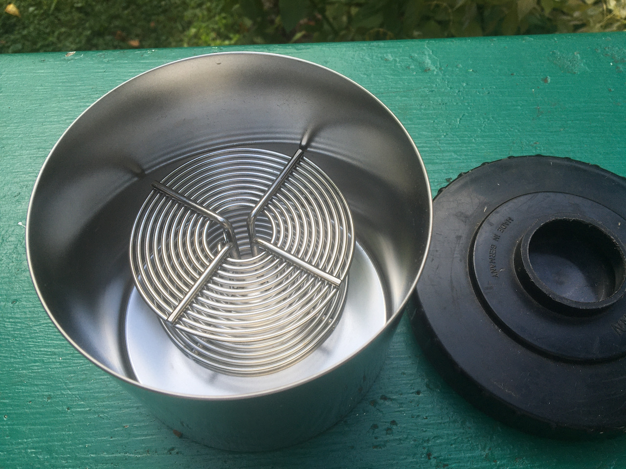

I just got a stainless steel Kindermann processing tank that was described on eBay as being for "35mm". There was nothing in the description or photos to indicate the size, but I thought the proportions looked a little odd. So I asked the seller if the tank was for one roll of 35mm film or two. The reply was "1" (only that). A one-reel tank for 35mm metal reels is what I was looking for, so I bought it.
But the tank is huge - an inch bigger in diameter than the 2-reel Kindermann I already have - and also as tall as my 2-reel tank. See photo which shows one of my 35mm Hewes reels in the eBay tank. I was specifically looking for a tank to be used with no more than 300mL developer, so I am returning this one.
Curious about what this tank was designed for, I tried to find an online resource that might show the Kindermann product line with dimensions, but no luck. Does anyone know of such a resource?
Thank you.

70mm reels are HUGE because they took 15 feet of 70mm film I think.
Measure the tank you got. If it's about 4.5" in diameter, and 3" height, it's probably for one oversized 220 reel. If it's 4.5" diameter and ~6" height, it's for two oversized 220 reels or one 4x5 reel. I know Nikor made these but I don't know that Kindermann did. They are not very common, so if it was inexpensive you might want to keep it. Admittedly, it's not clear what the use case for 1 oversized 220 reel is now, although one could develop two 120 films on it. The two-220 or 4x5 tank is a little more general.

I did measure the tank before I packaged it for return shipping, but not precisely. I believe the diameter was just under 4.5 inches (about 114mm), and the height was a little less than 3.5 inches (about 88mm).
Presently, I am shooting 35mm only, so I have no use for such a big tank. I just wanted to rule out the possibility that this tank might be designed for some kind of 35mm reel which I have never seen or heard of. This eBay seller lists a lot of camera gear, so it seems like they would be more knowledgeable, but apparently not.
Thanks to all for replies.

This one at 4.5 inches diameter was a tank for one oversized 220 reel, not for the 70mm reels that gorbas has.
Plastic tops for steel tanks work fine generally. Occasionally one breaks after 20 years. There are replacement plastic lids and caps for $5-6 from B&H or Freestyle. Hopefully they'll still be available in another 20 years. Steel lids work ok too - older ones may leak a little, but also, the steel caps have a tendency to pop off and get lost.
