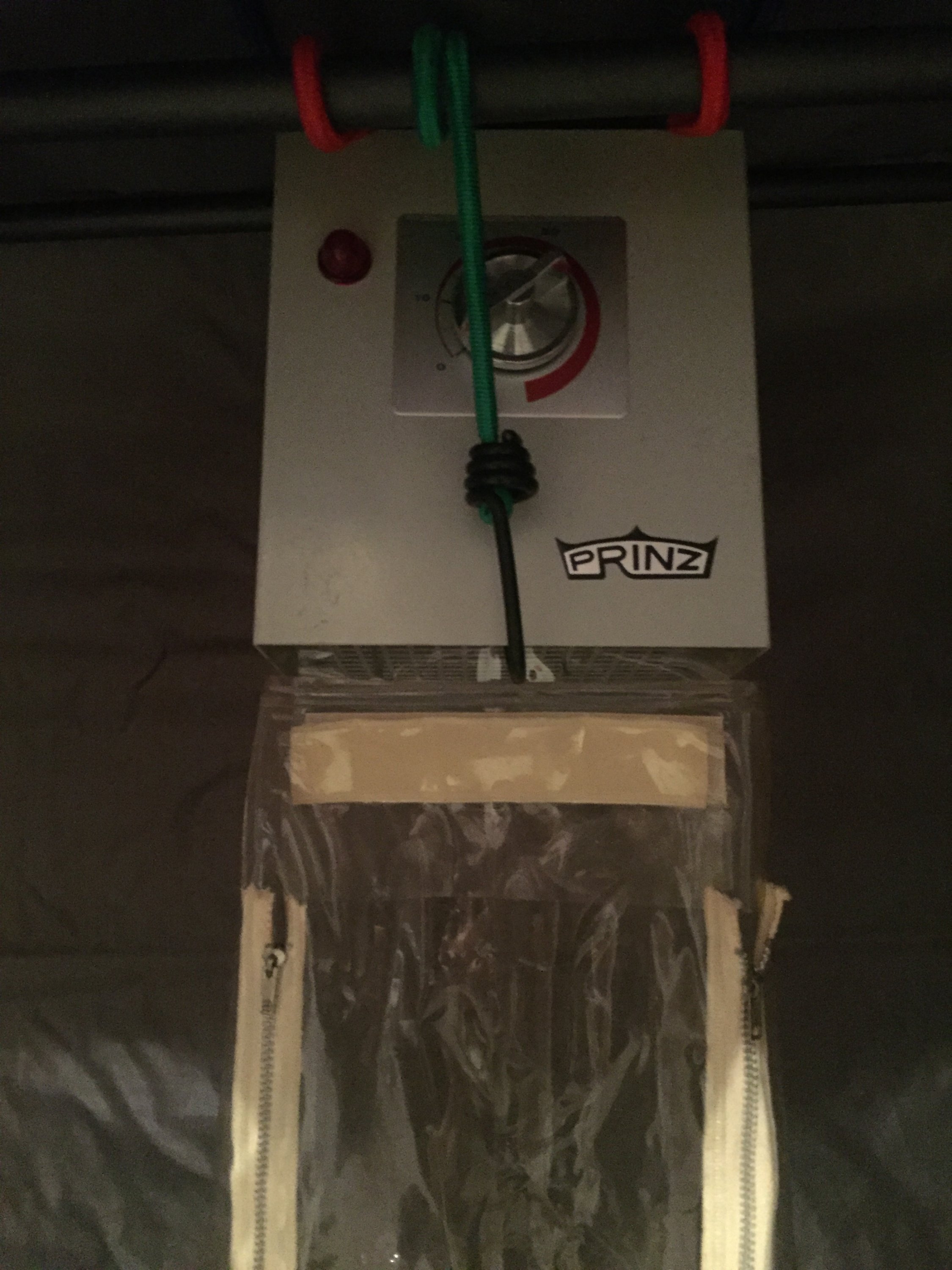

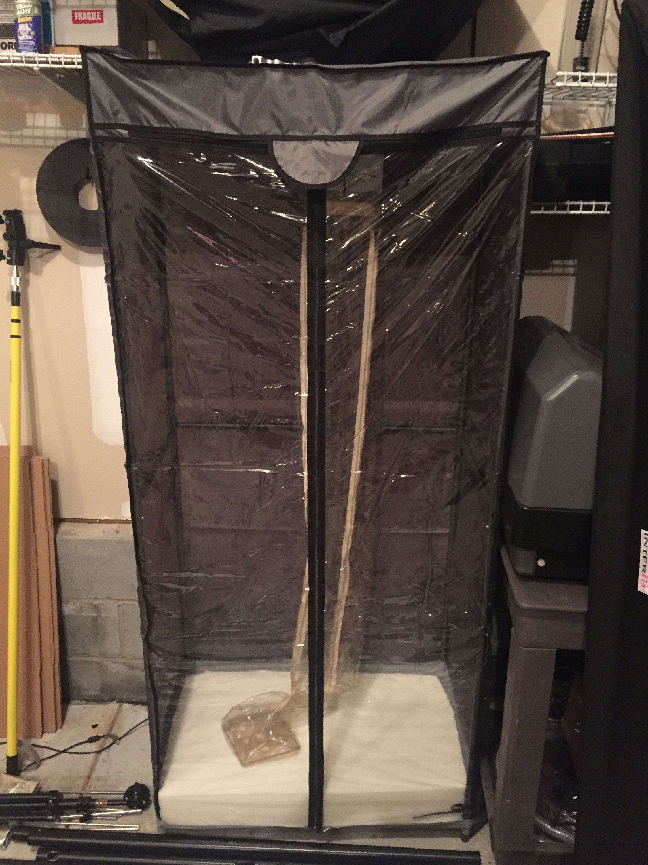

I solved this same problem by hooking the dryer head at the top of an inexpensive portable clothes closet I bought from Home Depot. The bottom was an open rack, but I went to the fabric store and bought a large rectangular chunk of 5" thick foam the size of the floor of the portable closet and taped the sides to ensure I locked out any dust entering from the bottom. I've since found a replacement "skirt" for the dryer head but still put the entire unit inside the portable clothes closet - now I have double the dust protection.Something like this:https://www.homedepot.com/p/Whitmor-30-25-x-68-50-Portable-Wardrobe-6905-5955/206296205
Here's mine.
