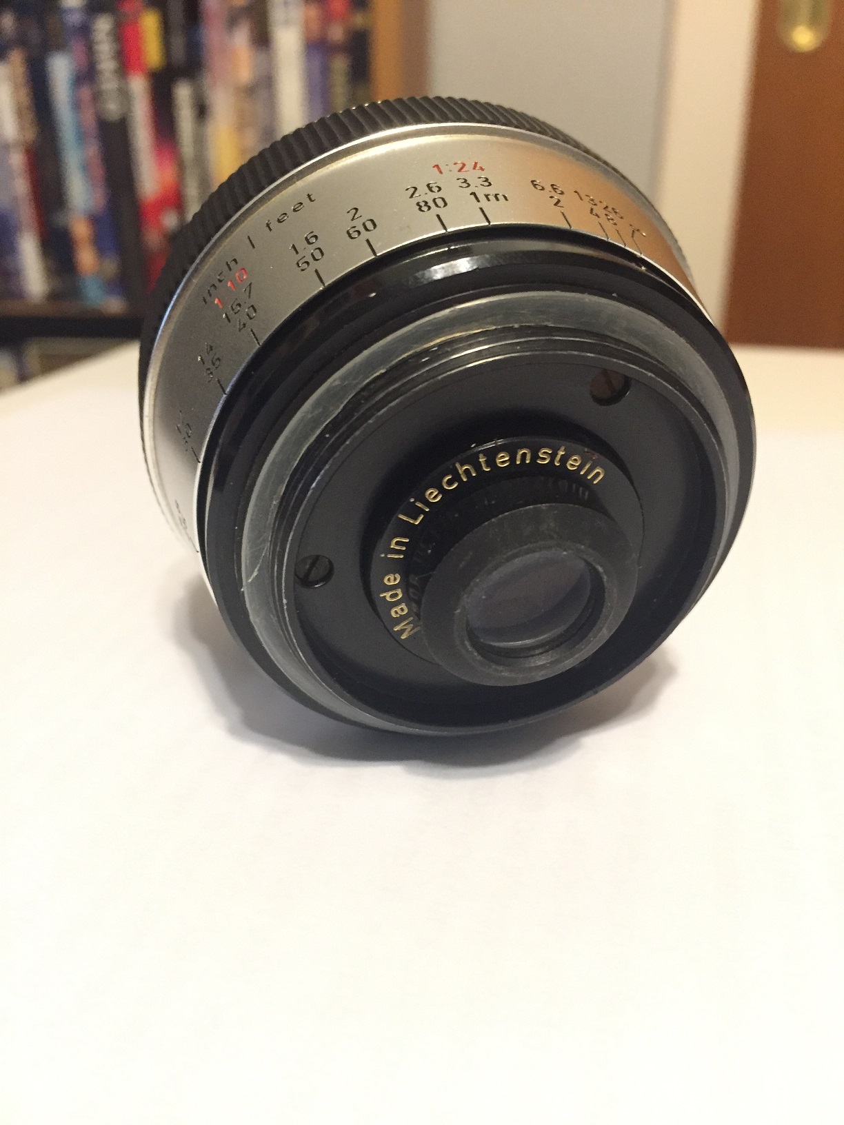

I had the good fortune today to stumble onto an M42 mount version of the 40mm Kilfitt Makro Kilar E f3.5 lens. Didn't ever expect to find such a lens at a thrift store, but I did and am quite happy to own it.
Haven’t had time to shoot with it, but I did however immediately mount it on my Pentax Spotmatic to check function and it seems to be in good working order.
Strangely enough, the lens has what appears to be a homemade spacer washer cut out of semi transparent plastic seated on the M42 threads. When I screw it onto the Spotmatic, the focus reference mark tightens up to approximately the 10 o’clock position as you face the camera. When I remove the spacer and remount the lens, the focus reference mark then tightens at approximately the 2 o’clock position. Very strange.
The threads engage smoothly, so there is doubt it is an M42 mount, but the out of kilter focus reference mark puzzles me.
Any possible insights as to what might cause this? I’ve never had an M42 mount lens tighten up this far out of alignment from the traditional 12:00 Noon position. Were there custom focus shims for each camera sold with the lens?

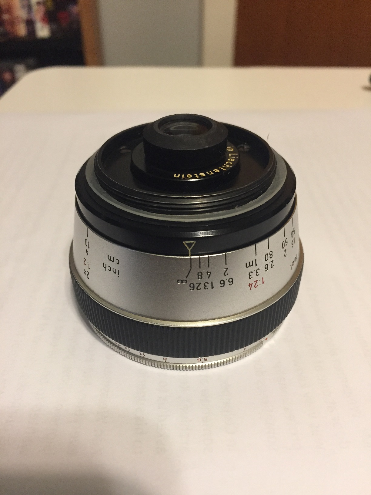

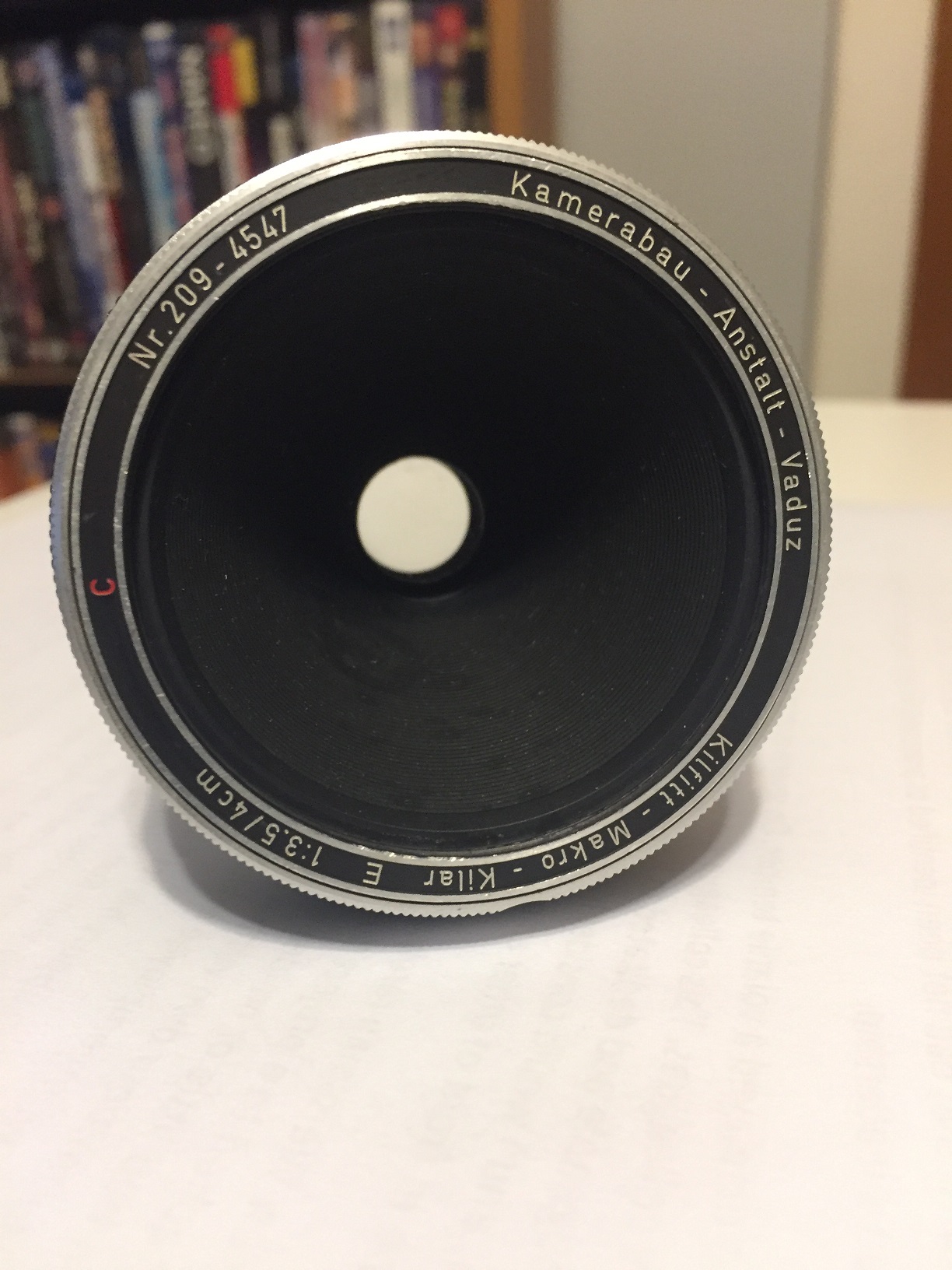

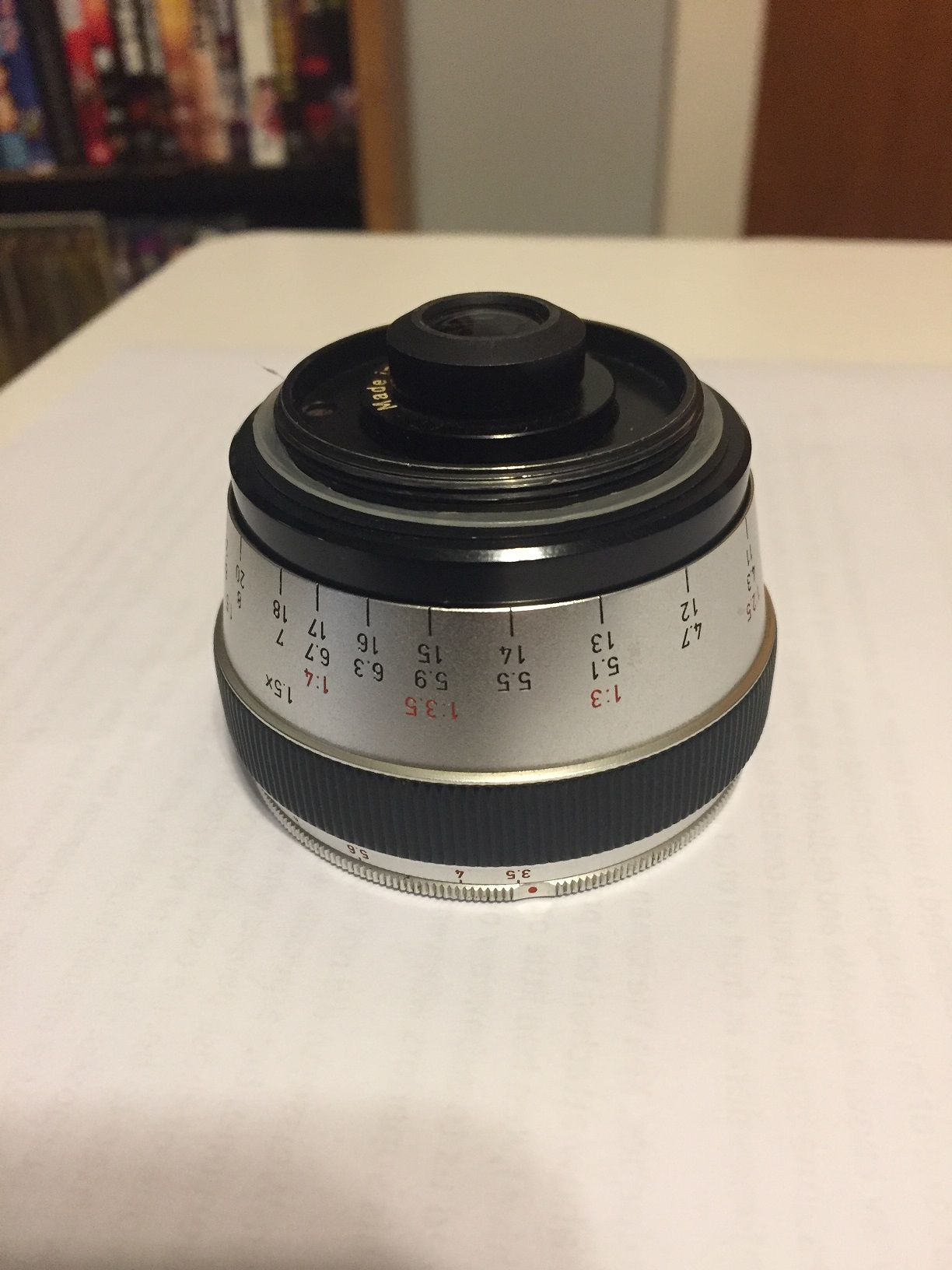

Pictures of your lens may help.
It would be strange that it hits the mirror (elements too far back) and that it can't achieve infinity focus (elements don't go far enough back). Try focusing on some object at a close distance - say 1m or 3 feet - and noting what the lens distance scale reads. From that it's possible to estimate how far off the flange distance is.
It's possible that your Spotmatic has a larger mirror than the Pentacon it was originally designed for. Here's another thought: could some part of the lens be fouling the stop-down pusher at the bottom of the Spotmatic lens mount? It's a preset lens, right? The camera it was originally designed for may not have had an auto aperture.
Kino
Kino
Jan 20, 2006
7,763
Orange, Virginia
Possible on the mirror size.
Doubt it on the aperture actuator, as the mirror was released when I turned the helicoid and retracted the rear lens element.
