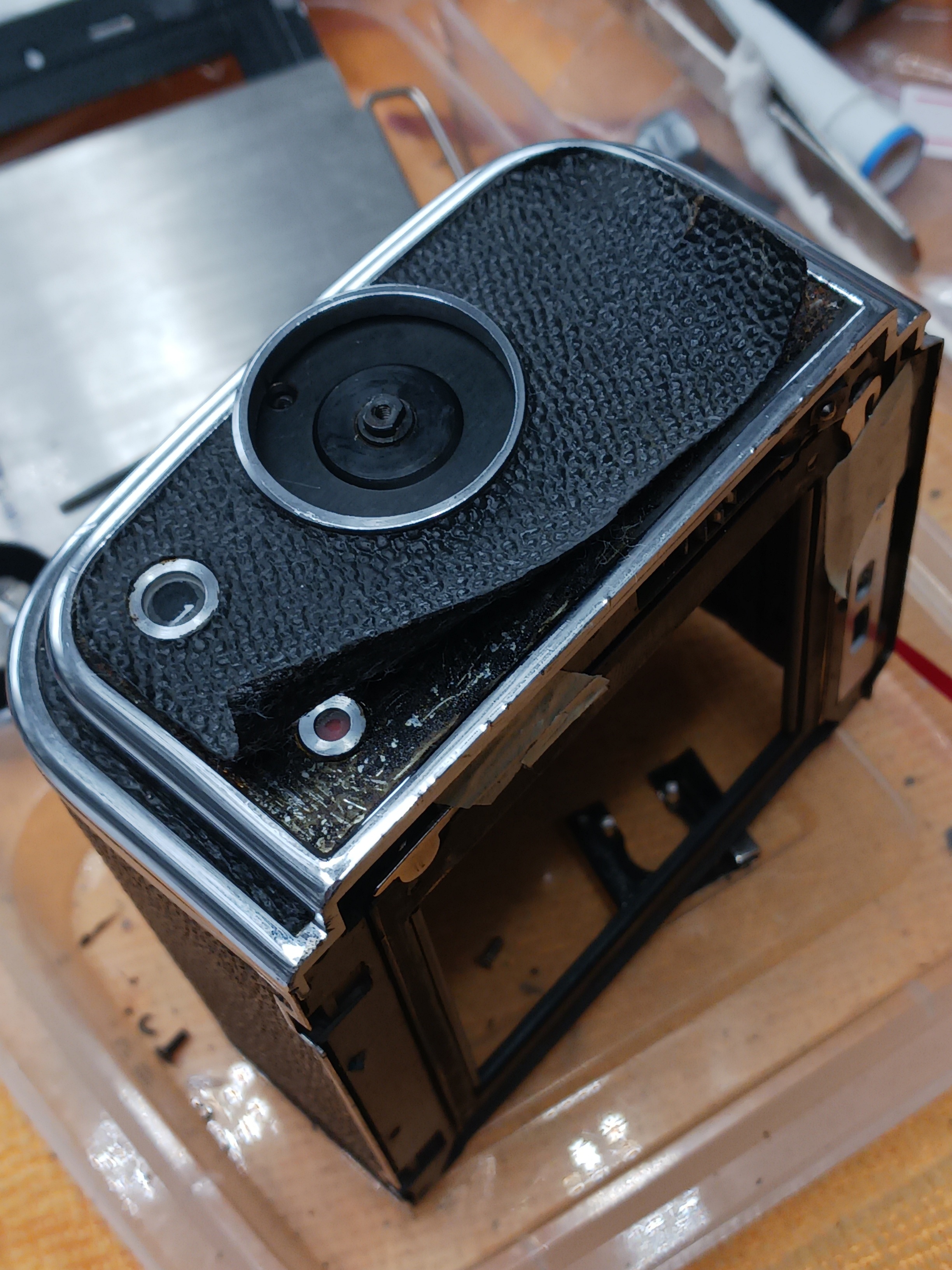

Hi Oapoli,
I have the exact same issue I am trying to repair. How did you remove the RHS cover? I can't see how it comes apart? I removed the 3 screws from inside too? It won't move at all?
