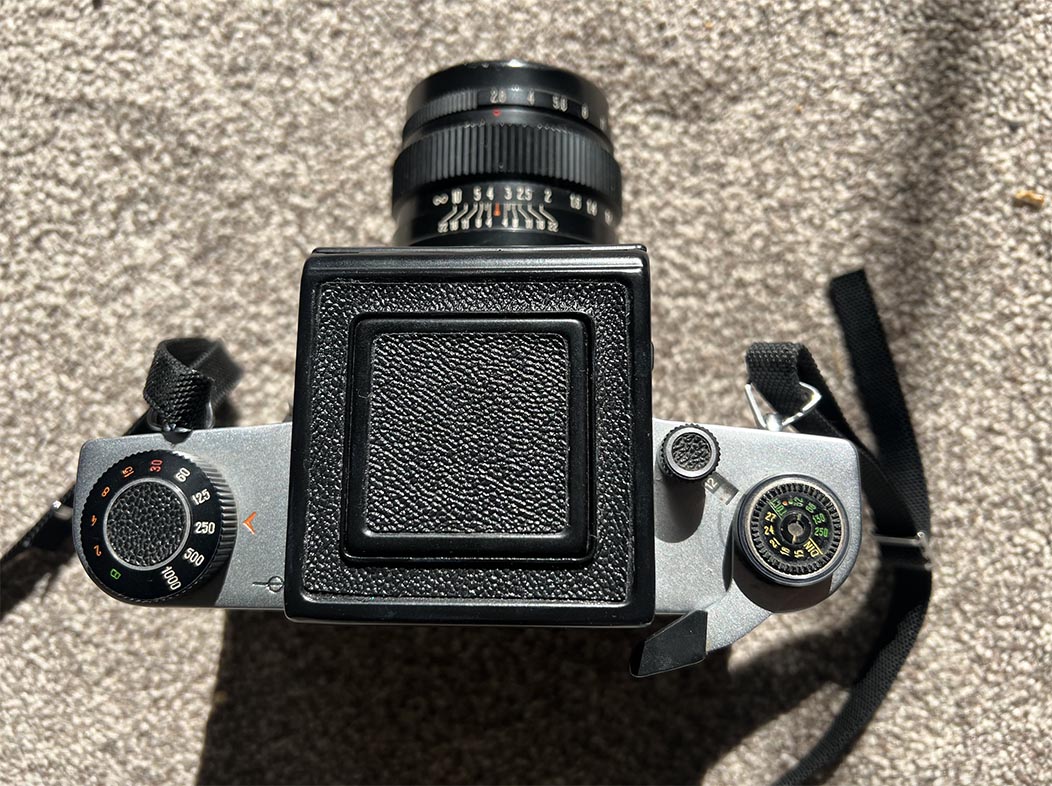

Had my Kiev 6C (it was made about 1981 going from serial number) for a little while and have used before once, but just a little confused about the ISO and how to set it. I bought a ton of film earlier in the year but I don't want to be making expensive mistakes by not setting the ISO to the correct setting.
I know it works via GOST/DIN but I'm unsure if I'm meant to use the red dot, or the arrows that line up with the green and yellow numbers. (Look at 2nd pic)
It seems like a really stupid question, but I can't seem to find any info on it.
Can someone tell me if I am going via the red dot or the yellow or green lines to get the film speed? Seems silly, but its not very clear to me.
Thanks to anyone that can help!

AFAIK this camera only has TTL metering with the prism viewfinder, which isn't installed on your camera. Looks like you only have a waist level viewfinder installed, which is unmetered. Since there's no meter, there's also no need (or possibility) to se the ISO on the camera. Set the ISO on the external light meter you'll use instead.

That's correct. You will need an external light meter or the TTL prism finder. The (incomplete) DIN scale is just for your memory and has no further function.

Should you get a prism finder for the camera, it's probably best you still use a hand held meter anyway for more precision.

That setting can be used to help remind you what film you have in the camera, so it is worthwhile to set it.
But otherwise, what the earlier posts say.

Thank you so much! I do have a prism view finder but there's no metering on that at all its plain with no extra bits. Think some of the very early Kiev 6C models didn't have that TTL! Do you know then if I wanted to push/pull any film if that is therefore possible? Or if it is would I meter as what I'm pushing/pulling the film to and inform the lab developing it? Say I wanted to use a 3200 ISO film at 1000, I'd meter to 1000 and let the lab know that I shot it at 1000?
