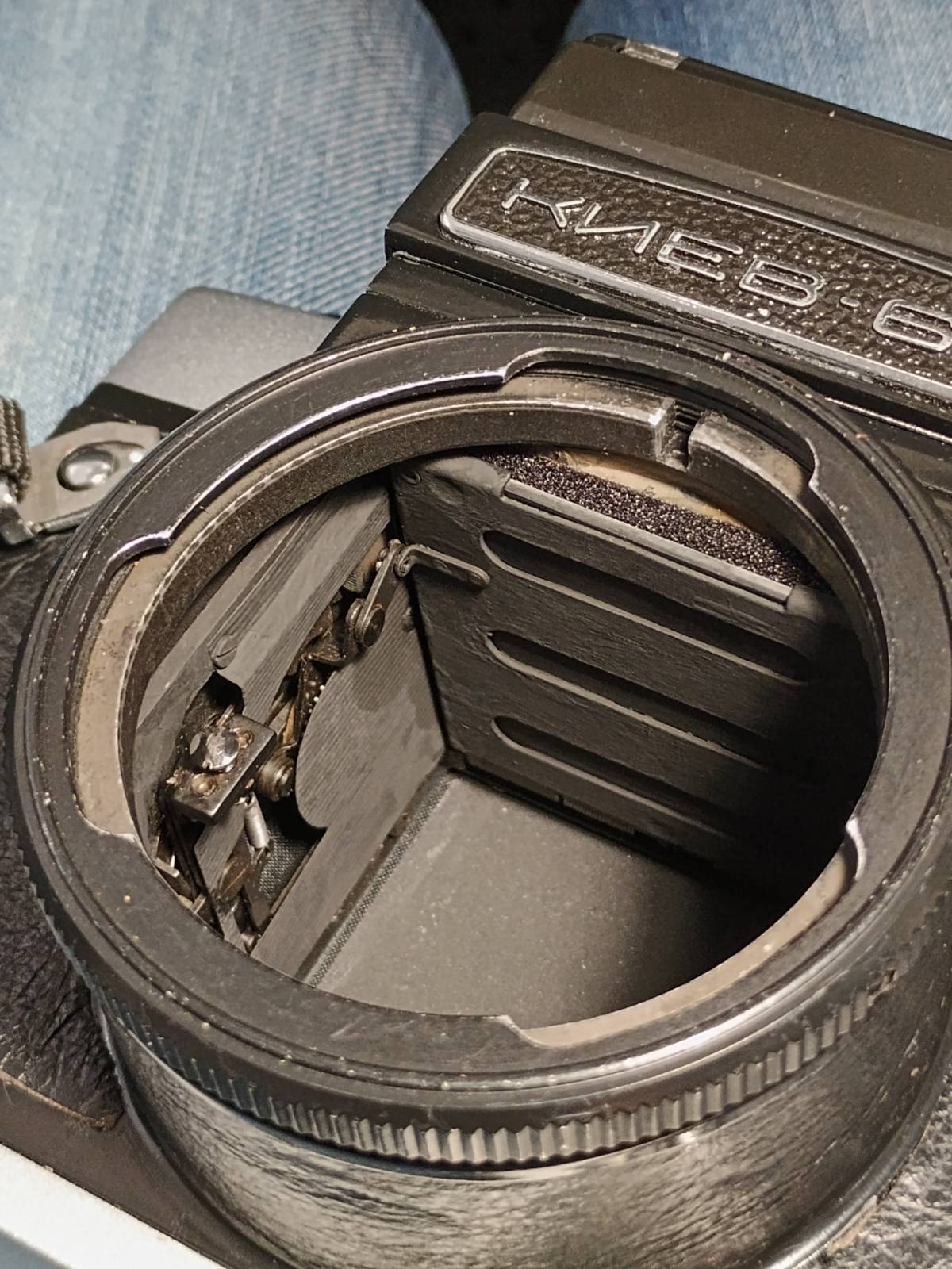

I don't recommend buying a defective Kiev 60. Repair may be expensive or even impossible. Look for a 100% working one instead. When a Kiev 60 is in good working condition, it is a reliable camera and better than the Pentacon Six.
The Kiev 60 has two issues:
1. The paint of the mirror box is glossy and causes flare. You can repaint with black matte charkboard paint or glue some velours foil inside.
2. The film transportation mechanism was designed for older and thicker films. Actual material causes no overlapping, but nearly no distance between each frame at all. If you can live with it, an exposure number 13 is possible.
To get normal distances between each frame, you need to thicken the taking spool. I glued some 1mm velours foil on it. However, the frame no. 13 is no more possible, but you get proper distance between each frame.
